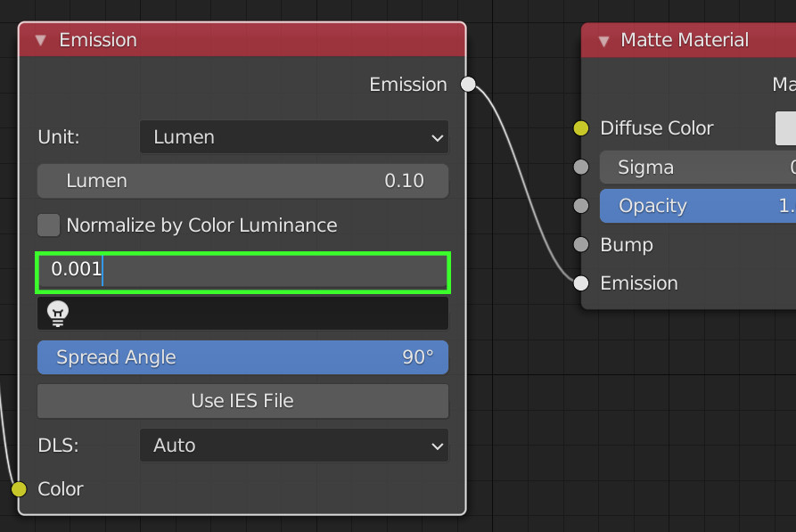

But Your Artficial light may be the cause of lot of fireflies. If it is the case give them an extremelly small importance Value :
In general mesh light source with lot of triangles destroy performances. It will make the light source visible without the fireflies
(while you can put point light + IES just under the light source wich is more efficient to sample for the engine)

Big thank You! This is really valuable recommendation for me, is what I was looking for. I tried these settings and the noise goes away much faster with them. Plus I couldn't figure out how to make a "fake" emission in LuxCore. Now I figure it thanks to you.Sharlybg wrote: Thu Oct 07, 2021 11:16 am That look fine considering you are on CPU. Maybe radius scale could be lower for speed up ( from 8 to 1 for example).
But it is still fine as it kept you away from artifacts( you can work with lower number when you are more advanced).
But Your Artficial light may be the cause of lot of fireflies. If it is the case give them an extremelly importance Value :
