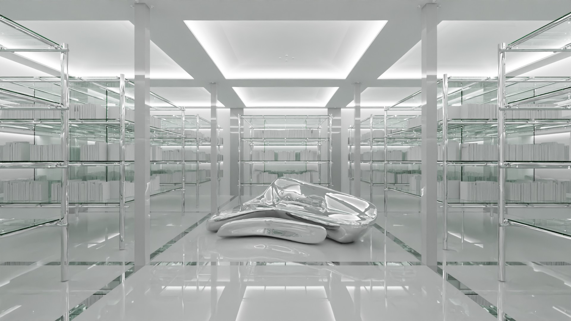

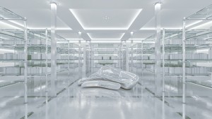

Hi, this post is intended to do some justice to Luxcore's bidirectional rendering engine.
To that end, I've prepared a scene that is not the typical HDRI + toy car. It's not a very pretty scene, but it reveals a lot of interesting information.
It is a very easy scene to set up, without textures, (textures don't reveal much about the speed of a rendering engine), so that everyone can repeat the test effortlessly on other rendering engines.
However it is a scene that easily represents the complexity of a modern store or bar or lounge, with shiny materials, lots of glass, reflections, and so on.
I asked the people who did the testing for two results:
First result with a very fast basic set-up, without tweaking the rendering engine
The second result with an advanced set-up, tweaking the rendering engine to get the best. No baking allowed. If there is any precalculation this should be added to the rendering time.
But since the following results were not all made by me I am not sure of their correctness. I'm only sure of the Luxcore and Maxwell Render results that I did personally. So I really appreciate any corrections from you guys. On rendering engines like Vray and Maxwell I decided to publish the results only on GPU because these companies claim the unconditional speed increase on GPU compared to CPU.
As hardware I put the best hardware available today, which means the nvidia 3090 and the Ryzen 3990, neither of which I own nor the people who did the testing. I simply scaled the result based on the performance gap between the hardware used and the results of official benchmarks on similar rendering engines. This is one of the benchamark pages I used: https://www.cgdirector.com/blender-benc ... ed-scores/
For example if the test in Vray was done on a 2060, to get the approximate render time on the 3090, I divided it by 3.6, which is the speed multiplier I re-encountered.
I know it's not normal to do it this way but I did it because it makes everything more intelligible.

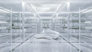

Here the results:
Luxcore Bidir on Ryzen 3990x
Basic set-up and advanced set-up - 8 minutes
Luxcore GPU Nvidia 3090
Advanced set-up - 2 minutes (is not the final one)
Light emitting objects had to be replaced by blender lights.

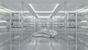

Cycles GPU Nvidia 3090 -
Advanced set-up - 2 minutes and 15 seconds

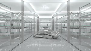

Corona 7 on Ryzen 3990x
Basic set-up - 11 minutes
Advanced set-up - 16 minutes

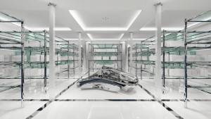

Vray RT on Nvidia 3090
Light emitting objects had to be replaced by Vray lights.

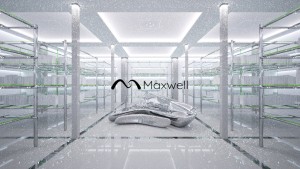

Maxwell Render 5.2 on Nvidia 3090
Basic set-up and advanced set-up 26 minutes
Lumion on Nvidia 3090
Advanced set-up - 10 seconds
Light emitting objects had to be replaced by Lumion lights.
White balance applied to all images in post.

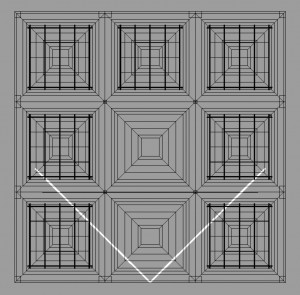

Following are the settings to replicate the tests:
Camera position: 5,0,1.2
Camera target: towards the opposite wall
Camera angle
Material and lighting description on the OBJ's layers.
Lux bidir has 24 light bounces, 256 ray bounces.
blender file https://drive.google.com/file/d/1I_qg7p ... sp=sharing
fbx file https://drive.google.com/file/d/1eIYmd_ ... sp=sharing

Interesting, but...
What about other engines like Cycles, Radeon ProRender, RenderMan, Indigo...?
Plus, it would be good to have full specs of the original scene (lights, colors, rays/bounces, ...) or preferably, attached as a reference. Especially, since Corona's results look quite different.

Yes i agree, i will also add indications about light bounces and raybounces. First let me update the existing results with the new scene, then i will try to test the other engines.
						Re: Luxcore vs rest of the world
I updated all the images with the new scene. Many rendering engines are missing i know.
But so far it seems that Luxcore Bidir is the only existing rendering engine that can be used for design verification.
Those who design lighting fixtures, crystal objects, car lights, museums, workplaces and so on, i.e. all those who need to know exactly how the light will behave in relation to their design, with luxcore bidir they just have to set the scene with correct materials and lighting and press render; the result will show exactly how the light will behave in relation to the design. As a result they can improve the design much earlier than usual.
With all other rendering engines you have to know beforehand how the light should behave and tweak the engine to produce something that looks realistic, something only extremely advanced users are capable of doing well.
Luxcore Bidir is in my opinion the ideal rendering engine for designers, engineers and architects.

Just be really careful that you do not bias your testing methodology to try to prove a pre-determined conclusion. In general, it would be optimal to try to be as fair and unbiased as possible, regardless of the outcome, and then let the results determine the conclusion.daros wrote: Fri Sep 10, 2021 12:39 pm Hi, this post is intended to do some justice to Luxcore's bidirectional rendering engine.
For instance, what were your constraints? Are you selecting a result where render time is fixed, sample count is fixed, similar amount of noise is desired, setup time is fixed, ...?
And what makes a "better" outcome? Least setup time, least render time, least perceptible noise, highest simulation accuracy, ...?
Why? Most path tracers are capable of tracing light from emission materials.
Hi Martini, you are probably right, I should have explained the test better.
Yes, the various rendering engines had to show the highest accuracy given a certain level of noise, which is hard to fix because some engines make more noise on causthics and others make more noise on glossy white surfaces and so on. But this is a reasonable result, I think.
Anyway, the file is available for download and it's very easy to set up so everyone can experiment and draw their own conclusions.
But I think this test is not very biased... it's the common benchmarks where rendering engine weaknesses are kept hidden that are biased. This test simply requires the rendering engine to be able to solve multiple problems simultaneously, which is a very common need in production.
As for the issue of light-emitting objects, maybe I got something wrong, but these light-emitting geometries are apparently not digested very well by GPU rendering engines. GPU engines are simply not able to render them properly, so we had to replace them. In the Vray test you can see this clearly.
