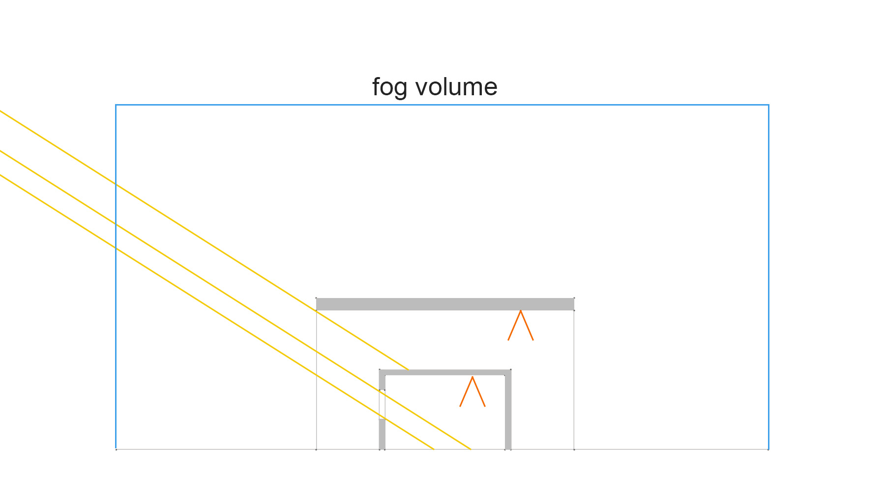

Imagine this scene, which is an outdoor/indoor scene.
We want this:
-placing the camera on the outside of the building, get a fog effect limited by the blue volume.
-placing the camera in the semi-closed volume we want to appreciate the volumetric of the sun entering the large opening and the voluemtric of the spot on the ceiling.
-by placing the camera in the volume that has only a small window we want to obtain the effect of the volumetric of the sun through the window and the volumetric of the spot on the ceiling.
Which is simply what would happen in reality under such circumstances.
To simplify... we are looking for a set-up where everything that happens inside the fog volume is immersed in the fog.
We have not been able to create a scene in which, simply by moving the camera from outside to inside, the volumetrics behave as they should.

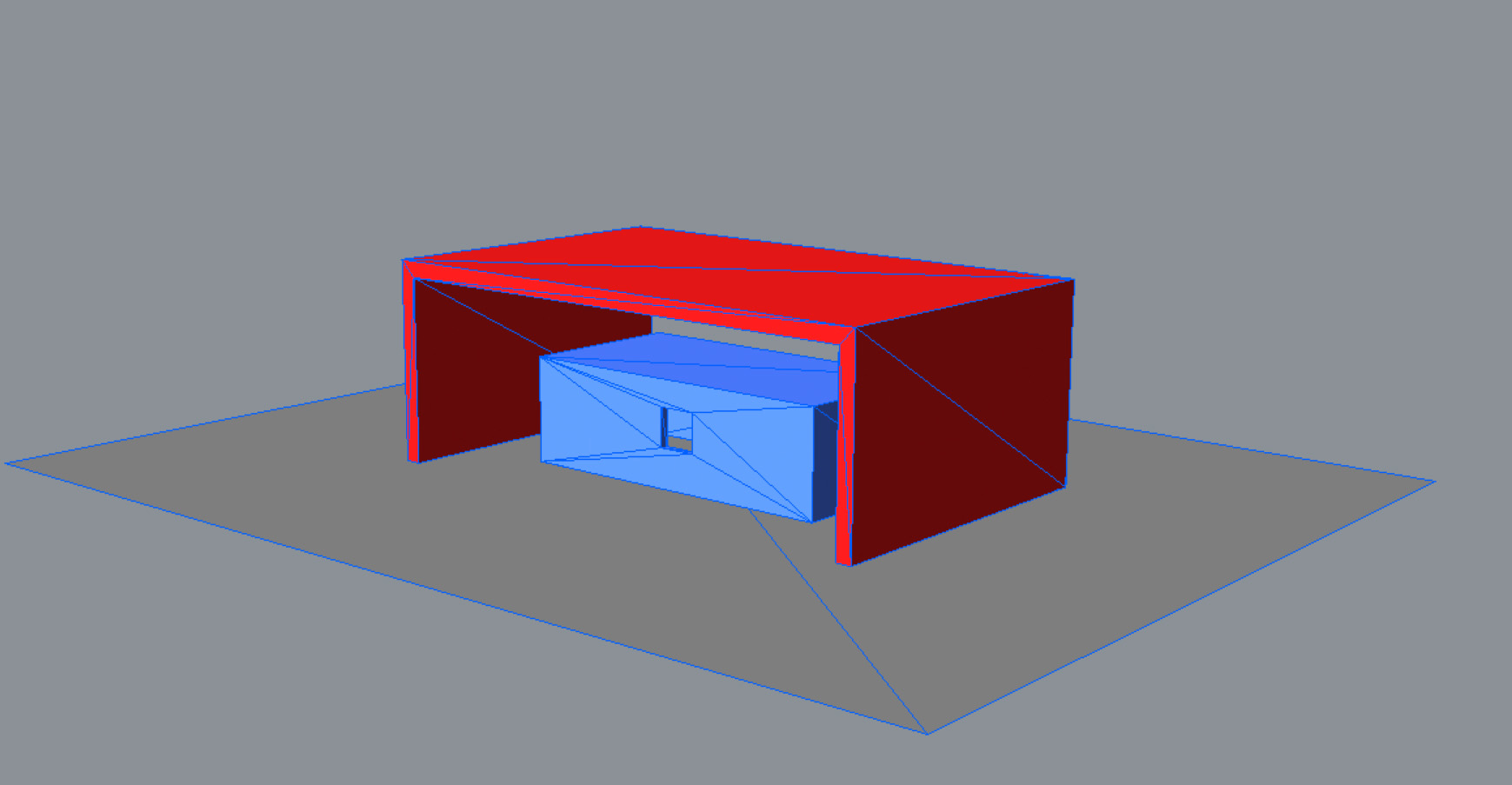

Attached is an obj of that scene.
Can anyone help us create a scene where by moving the camera from the outside to the inside, we can get the correct results?
Thank you in advance for your help.

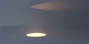

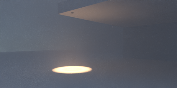

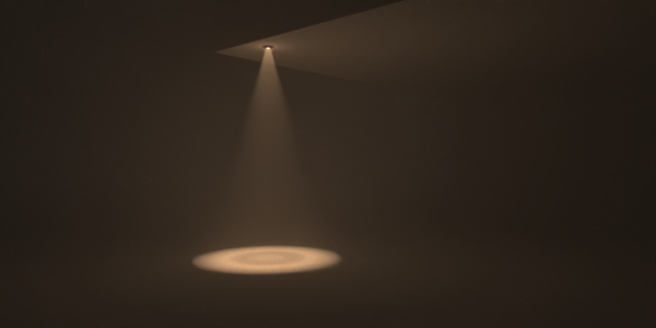

Even in this scene, which has to be considered an exterior scene, i cannot explain myself why i cannot archive the correct result by using a internal volume:
this is the result with world volume.
this is the result with the scene imersed in a internal volume.
Why in the second case we apreciate the volumetrics occluding parts of the scene but not interacting with the light?

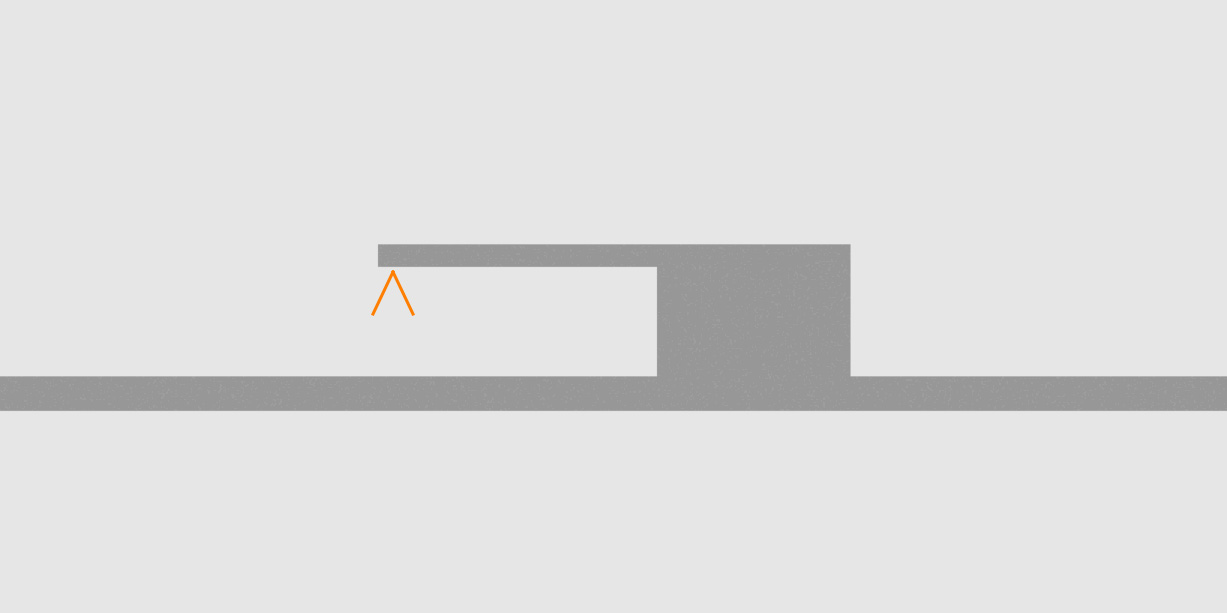

The scene looks like this:
Attached you can find the geometry.
Please help!

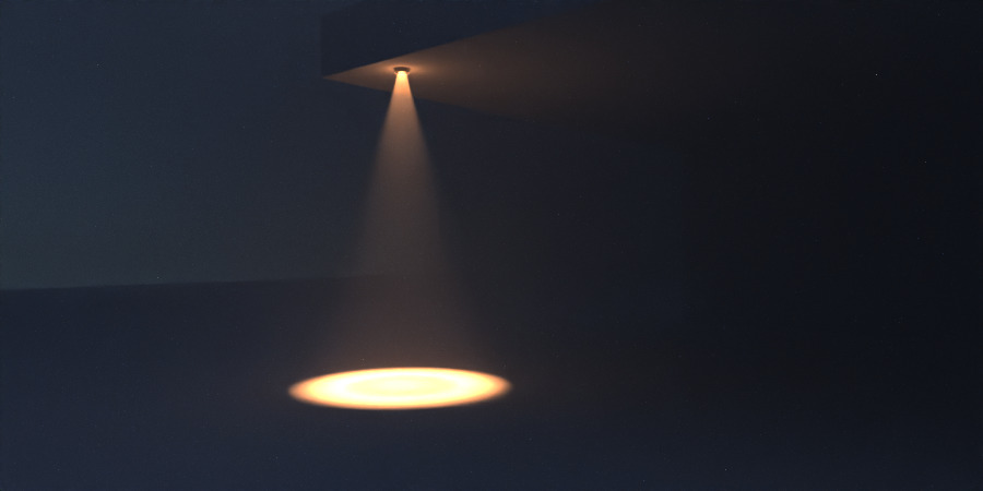

Re: Volumetrics issues
daros wrote: Tue Sep 21, 2021 12:45 pmHere they are:
As written in my first post:
Dade wrote: Fri Sep 17, 2021 10:55 am I assume you have not defined the inside/outside volumes of the walls: the rays starting from the the light sources hit the walls and, at that point, LuxCore try to deduce the volume the rays were traveling in but the walls say there was no inside/outside volume. This is a problem because the light sources are inside the volume box.
If you add the following line to the scene:
scene.materials.83042_4.volume.exterior = "envVolume"
It will work:

But does this not creates an infinite volume around the scene? Why your render is so much darker?
Your render should be simply the second rendering with the volumetrics of the first one...
At least this is what we are looking for.
