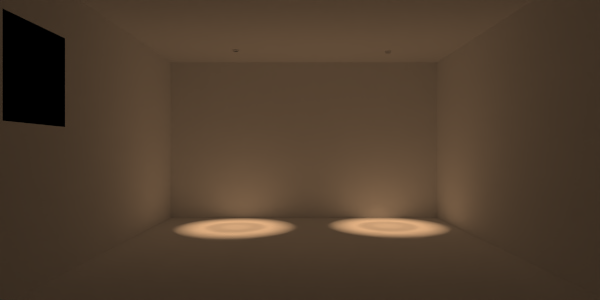

this is the scene without volumetrics:

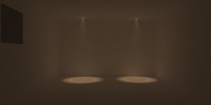

this is the scene with volumetrics applied to world

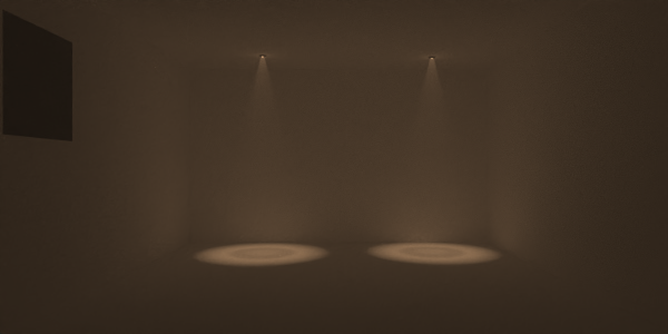

this is the scene with volumetrics applied to a box which is slightly bigger as the scene.
why the box version subtracts lighting to the scene without showing the light beams?
