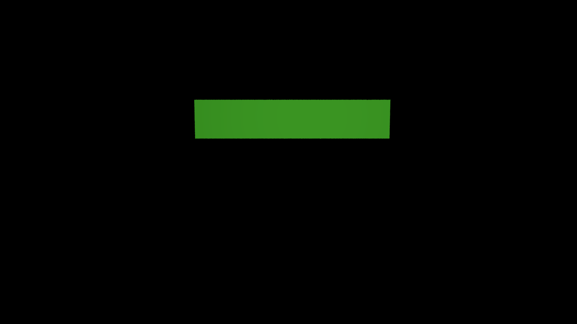

Thanks, I stripped out basically everything except an area light and a plane.
Luxcore v 2.4 shows a green plane.
Luxcore v 2.5 renders black image.
Thanks for any ideas...

output from luxcore v 2.4
Re: scene from luxcore v2.4 doesn't render in 2.5
The scene has some wired setting for the default light group, I'm not sure where they are coming from, they may be the result of some change and new support for light groups added to BlendLuxCore in v2.5.
As work around, just create a new light group (under Scene properties tab, LuxCore light groups panel) than assign the light source to the new light group (select the light source, under Object data properties, select the new light group).
This will reset the light group data and the scene will render as in v2.4.
