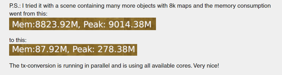

Steffen Dunner has been doing some tests with the Texture Caching branch from Stefan Werner, and he did a test with a ton of 8k textures, I have to say that the results are incredible:

This would be amazing, just with this the amount of memory taken by textures in general could be reduced A LOT and that would make 8Gb GPU's much more viable to render serious projects :)

You may misunderstand the feature: it is only for CPU rendering. It is what Arnold does (actually .tx is an Arnold format): the images use mip-maps and are broken in tiles, and you load the mi-maps/tiles on-demand, when they are required for the rendering. It allows to use very large image data sets and a very fast starting of the rendering (people uses 100+GBs of textures with Arnold).
I can add the support for it but it is cpu-only and, given most people use GPUs for rendering, doesn't sounds very useful.

True, however Stefan is working in the GPU version of this, in Cycles it will support both, GPU and CPU :)

On GPUs, it will suffer of a HUGE (really HUGE) performance hit. I assume it will be no different from using out-of-core rendering with LuxCore.

Every option to get around (GPU) memory problems in Luxcore already suffers huge performance hits, loss in quality and often doesn't work at all (like out of core). You might maybe want to keep an eye on this development and if it's stable, you can ditch "Tiled Path" and "Out of core" and end up having a viable alternative.

However, what do you think about using MipMapping, something that is native for the GPU's and maybe can be easily handled? (I may be wrong, that's why I ask :) )
