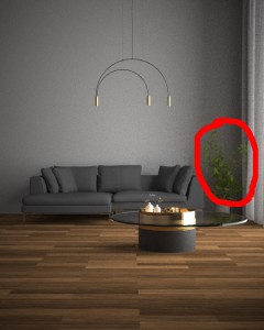

[CRASHING] Simples scene crashing on RTX2070
Re: [CRASHING] Simples scene crashing on RTX2070
I may have been able to replicate the problem, I'm looking into it.

Dade wrote: Fri Apr 16, 2021 9:31 am I may have been able to replicate the problem, I'm looking into it.
The problem seem related to the plant in the corner:
@hilth, if you erase the "leaves" and "trunk" objects (i.e. the plant), does it still crash for you ? It works fine for me.
The problem seems also to to be CUDA-only, OpenCL rendering is working fine for me, even with "leaves" and "trunk" objects.

Dade wrote: Fri Apr 16, 2021 10:26 am
hey guys!
Yep! It works.
I deleted the plant and the scene load got rendered.
both in the viewport and by pressing F12.
JulianoLisboa
Posts: 146
Post by JulianoLisboa »
Wonderful. Very good! Remembering that this plant is part of the online library of luxcore, it would be good for the developer to take a look at it.
