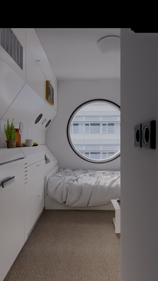

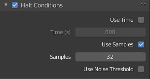

Just testing an animation with Cache friendly because of the speed bump (from 3.5 Ms to 5.4 Ms ) and look like some of the rendered frames aren't completed. There is no Lightracing and the halt condition is set to 32.
Re: Cache friendly incomplete render
Sharlybg wrote: Sun Nov 08, 2020 1:31 pm There is no Lightracing and the halt condition is set to 32.
You need to set an halt condition only for the eye pass (not for eye+light).

The Blender addon is doing that already: https://github.com/LuxCoreRender/BlendL ... alt.py#L39
Anyway, it shouldn't matter in this case, since light tracing is not used.
Dade wrote: Sun Nov 08, 2020 4:26 pm Than it is this: viewtopic.php?f=4&t=2700&p=26026&hilit= ... ion#p25999
The "cache-friendly" setting in the Blender addon should result in 32 samples per iteration: https://github.com/LuxCoreRender/BlendL ... ig.py#L302
So 32 samples should be the correct halt condition.
@Sharlybg: can you reproduce it in a simple testscene?
What number of samples is reported after the rendering stops?
Currently i just set the halt condition samples higher (128) to avoid such black cut. But i get random final samples/pixels (129/133/136/128/135....)
Will have to wait for tomorrow to make a simple scene and try to reproduce the issue as the current computer is rendering the animation.
BTW would like to have a TUTORIAL on how to setup AWS server for Luxcore 2.5 will be great as the Luxit thing is still in the Blur side .... :roll:
Sharlybg wrote: Sun Nov 08, 2020 5:39 pm But i get random final samples/pixels (129/133/136/128/135....)
It is normal that the render can stop at slightly more samples than set in the halt conditions. But in theory it should never stop at less, unless there's some bug or other problem.
