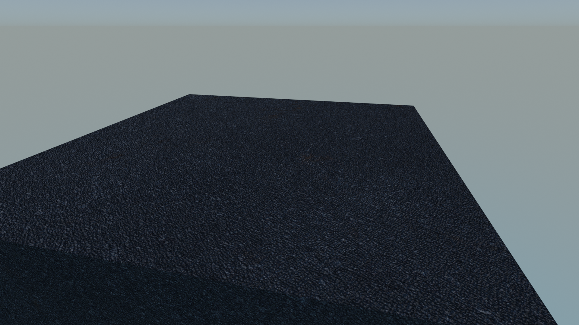

GPU Path Tracing w/ Normal Map:

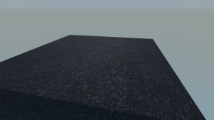

GPU Hybrid Tracing w/o Normal Map:

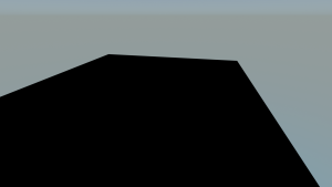

GPU Hybrid Tracing w/ Normal Map:

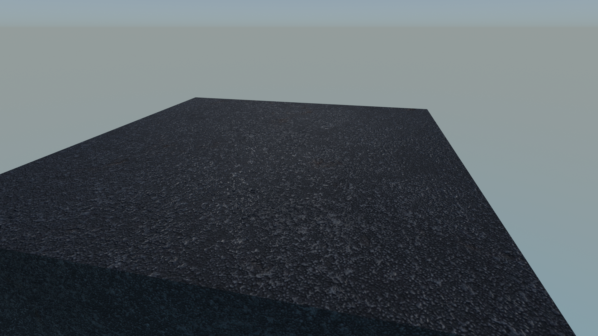

GPU Hybrid Tracing w/ Normal Map as RGB Image ("Normal Map" unchecked):
