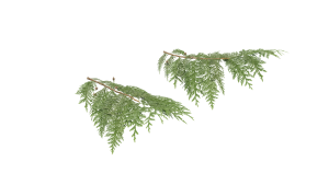

Using same file and mirroring the object Y Global you can see the difference below:
CEROE
Posts: 54
Joined: Wed Jan 09, 2019 11:34 pm
Re: TwoSided material
Post by CEROE »
Referring to previous post, if it is not obvious, the top image is Cycles and the bottom image is Lux.

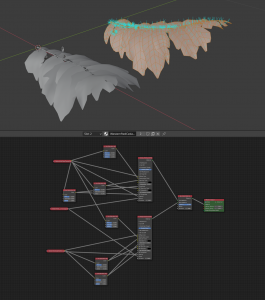

The normals do not flip on the mirrored object, but the frontside/backside material switches in Lux. This does not happen in Cycles (Top render in previous post).
Below shows the normals of the mirrored object.
Lux is switching the frontside/backside material on a mirrored object.
