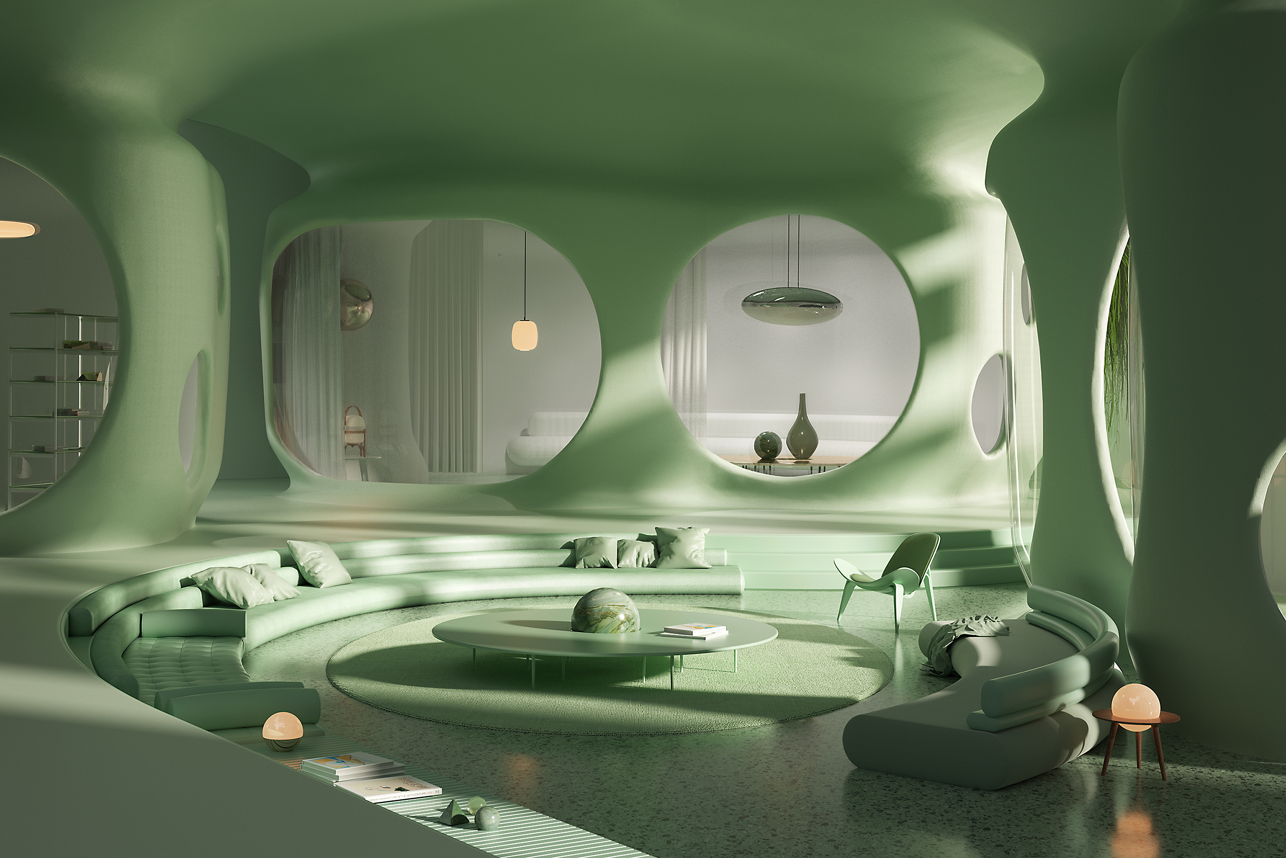

Thank you so much for your reply. I am trying to achieve somehow a dreamy look. Probably influenced by the trend of people using octane and doing abstract archviz renders. I think you are right, the harsh shadows are not benefiting the product. I do believe the mood I want to go could fit, but I am not achieving it. Here a render that looks illuminated by a sun...
Of course the room is different and having more assets makes it totally different. But it does seem lid by a sun only.
Here are other renders that exemplify the mood I want to achieve with the light: Taking aside that they are using a surrounding space much more interesting than mine...the light is the one I would like to achieve.
If it helps I could share my settings. I would really appreciate if you could advice me about how they are illuminating their renders.
In my case it is important to show the grid of the table casting on the floor...so somehow needs to be a light that cast the shape correctly but still in a more refine matter than my render so far.
Thank you a lot again

To me they are like hdris through a window.
Look at this source.
https://hdrihaven.com/hdris/
Use one that makes soft shadows.
Regards.

Re: Looking for advice (furniture render)
I think this is useful (interior hdri) if you make close captions or if you have backplates of the same environment.
In your case, I would model the space and outside put an open environment hdri map.
Regards
Regards
Thank you so much for all your help. I am having closer renders showing the details of the furniture and the idea is to show it in a  context like the one I posted as examples previously. I am thinking if you think those examples are using a sky hdri or something different. I guess what is left now is just trying to do it, but I am kind of engaged in understanding these type of renders that portray a "dreamy" feeling.
