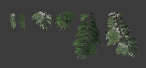

			There are a couple issues:
The backside seems to be extra glossy. I have tried the same settings for each, and the backside is different.
When mirroring a twig the faces are also switching.
