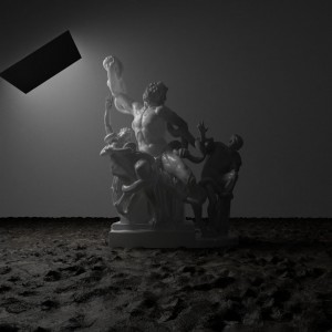

This is my first test with LuxCore Volumetrics, sorry if the solution has already been mentioned in the forum. I searched but no luck.
(Ignore the quality of the image, it's for testing purpose only)
Basically, I'm translating what I usually do in Cycles to Lux and I'm noticing something strange happening at the boundary of the ground plane.

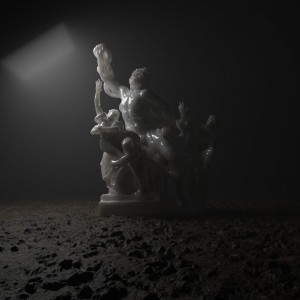

This is the same scene roughly translated for Cycles
As you can see, the background in Cycles gets more muted and the ground blurs into the environment in a more, gradual way.
In LuxCore there's a sharp separation between the ground plane and the volumetric.
On top of that, the light has sharp edges (having the light visible doesn't fix the problem).

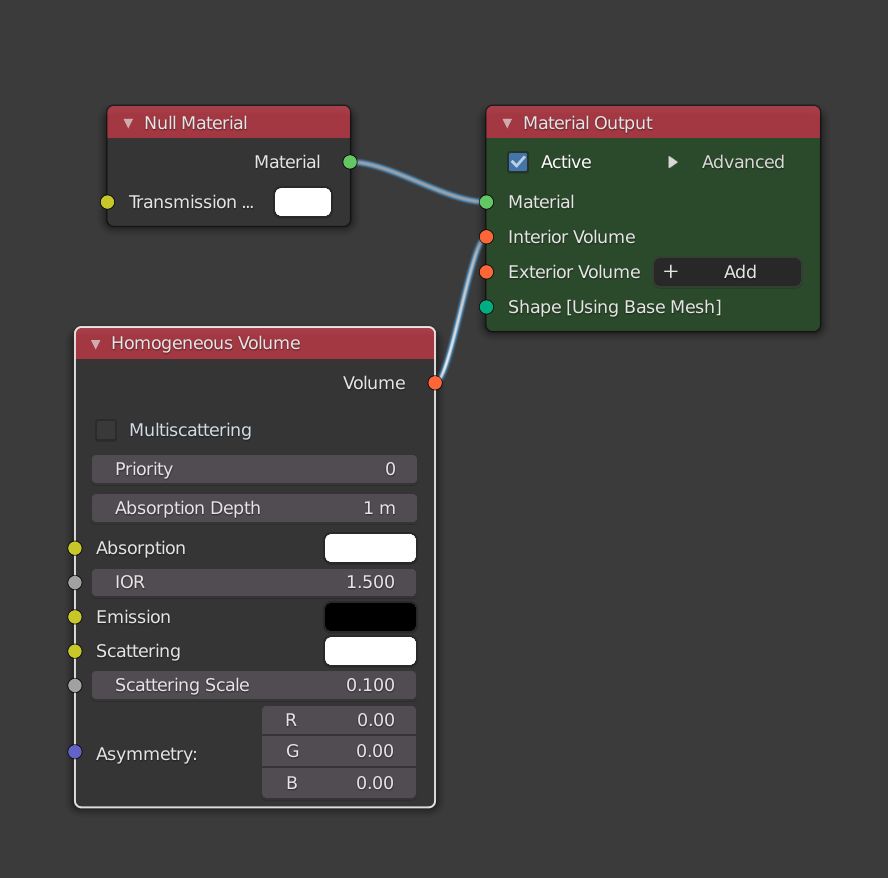

Here's my basic setup for the volumetric cube:
Any hints?

I usually define an external volume called Air.Clear.Volume.Prio.0 first. Then I define further volume, the internal volumes. In your case Air.Homo.Vol.Prio.10.
IOR are predefined in an utility node.
Then I set World volume and define Camera volume by choosing Air.Clear....

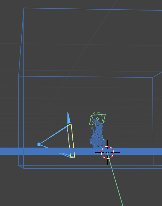

The camera should be located outside your cube with Material Null.
I hope this helps as a useful hint.

It works also if it inside and you assign the volume to the camera.

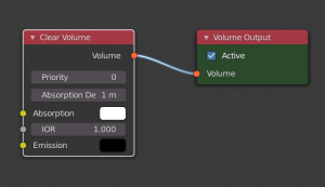

I disabled the Auto-Detect, created a new Camera Volume which has these settings by default
And now I guess I can simply have my cube with the Homogeneous Volume extending past the camera.
Do I need to change any setting in the Camera Volume shader?
At the moment the result hasn't changed, I'm back to the clipping issue in the first image I posted.

If the camera is inside the fog, you need to set the fog volume as camera volume.
(it is the camera exterior volume)
