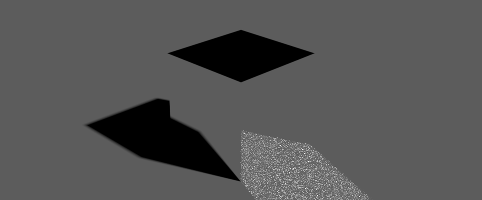

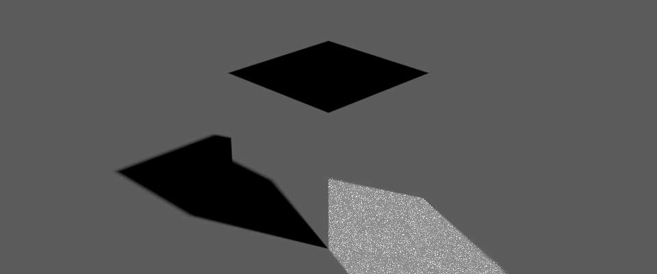

Denoised. 12K samples PhotonGI (no Light Tracing)
Raw render. 12K samples PhotonGI (no Light Tracing)

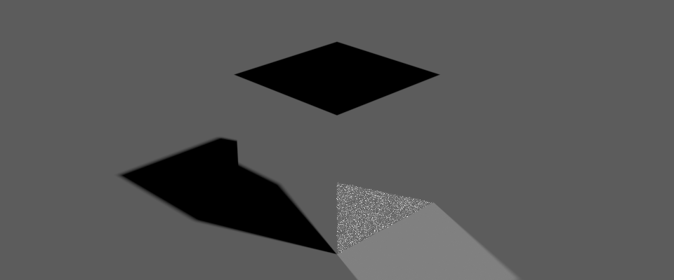

If I disable the PhotonGI cache and use Light Tracing, the result is still quite noisy at 12K samples; the brightness is equal.
Denoised. 12K samples Path + Light Tracing (no Photons)
Raw render. 12K samples Path + Light Tracing (no Photons)

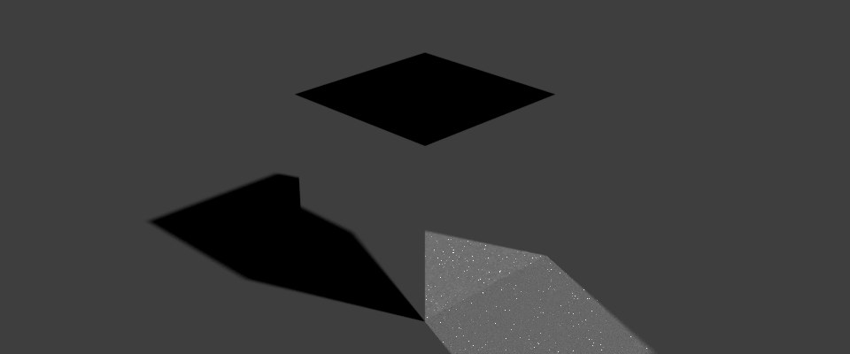

If I disable the Light Tracing as well (pure path tracing), the brightness is equal, although a little noisier at 12K samples.
Denoised. 12K samples Path (no Light Tracing, no Photons)
Raw render. 12K samples Path (no Light Tracing, no Photons)

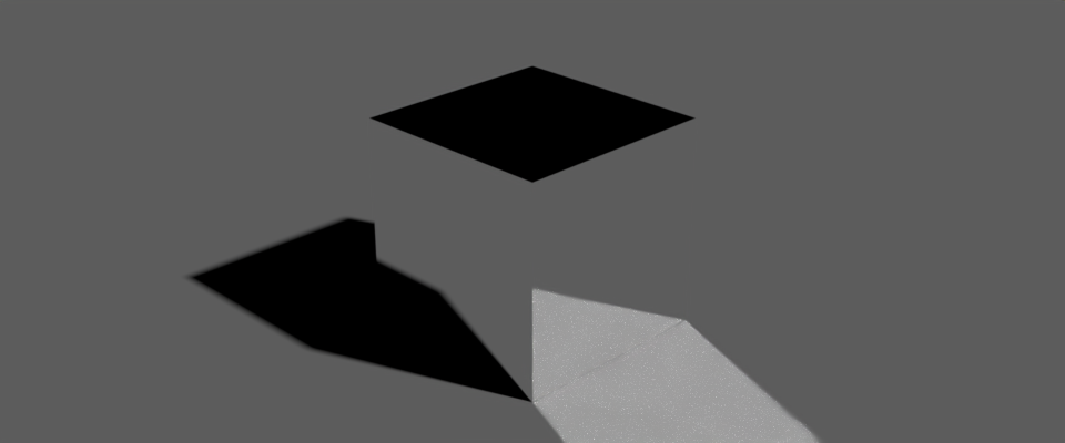

With BiDir Metropolis at 2K samples I get almost the correct brightness, it's just a little brighter in the reflection. :?
Denoised. 2K samples BiDir Metropolis
Raw render. 2K samples BiDir Metropolis

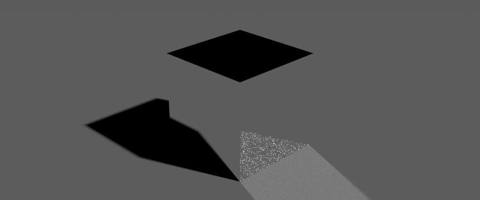

With BiDir Sobol at 2K samples I get equal brightness, it's just... very noisy and will take a long time to converge.
Denoised. 2K samples BiDir Sobol
Raw render. 2K samples BiDir Sobol
