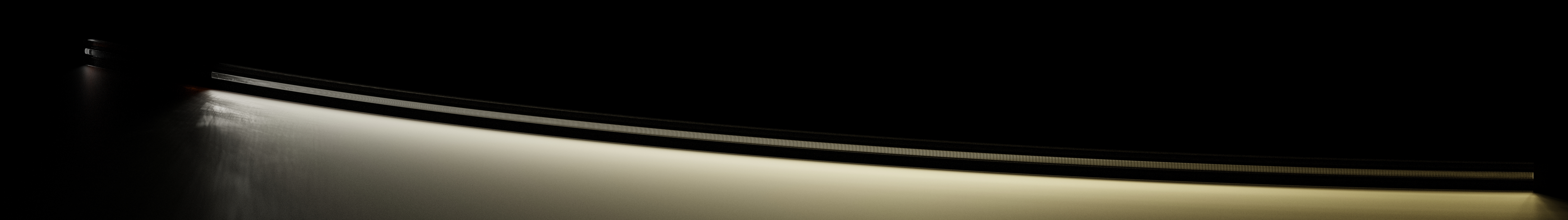

with complicated light paths I meant something like that:
I've added the blend-file to that post.
If you'd like you could try to find a solution to reach this result without biDir.
It would be really helpful for me to find something to speed those kind of visualisations up.
Thanks in advance.
BR
LL2.zip
(1.83 MiB) Downloaded 1249 times

Not sure what's the problem, just switch to gpu and enable lighttracing.
This way I went from about 163K rays/s to 5M rays/s in your scene.

lacilaci wrote: Thu Jul 02, 2020 12:22 pm Not sure what's the problem, just switch to gpu and enable lighttracing.
From now on you're my personal hero. A test scene runs much quicker than before and reaches the good result in a time that I could get little animations with a single weekend of rendering.
Thank you very much.
