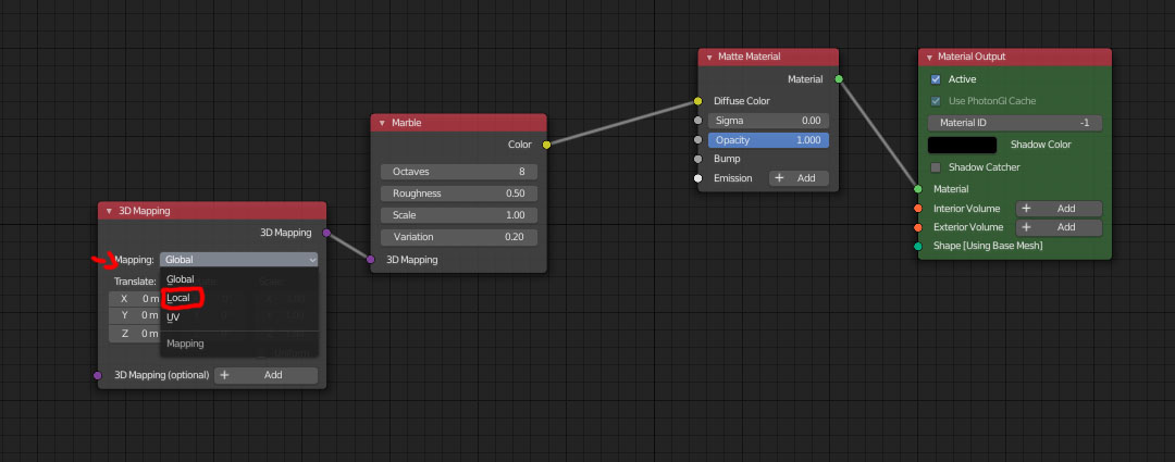

Dade wrote: Tue Jun 02, 2020 12:23 am You need to use local object space mapping (I have no idea I it is called inside Blender :?:).
I don't see any option in blendluxcore to do that to change to local object space mapping.
neo2068
Posts: 260
Re: BlendLuxCore Development
Post by neo2068 »
Sharlybg wrote: Tue Jun 02, 2020 9:51 am I don't see any option in blendluxcore to do that to change to local object space mapping.
You have to add a 3D mapping node. There you can switch from global to local mapping.
Nice thank you never though about that one :)
Sharlybg wrote: Tue Jun 02, 2020 10:40 am
tested doesn't work too. but seem that switch to UV instead of local/global work.
