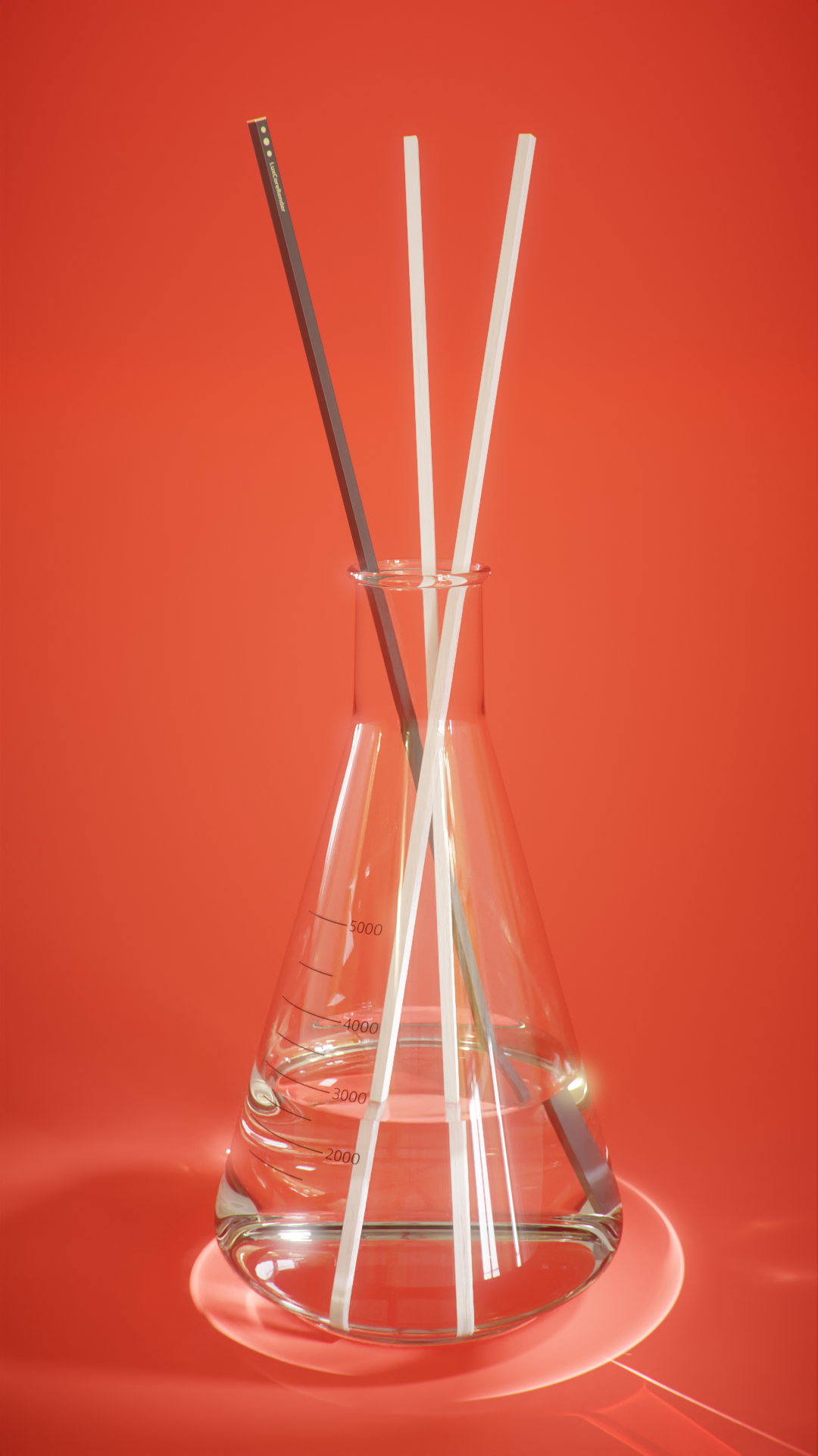

I had this scene rendered in 2.2 and I tried to render it in 2.3 and 2.4 but I can't get it to look the same.
The attached image is how it looked in 2.2
I tried both Blender 2.81 (in which I originally made the scene) and 2.82
It seems like the the "laser" and the mesh light have no effect on the lighting?
I tried various options, light tracing etc, but didn't seem to make any difference. Tried both CPU and OpenCL (on RTX 2070 Super)

Awesome, that works! Thanks! I can get it to work with the CPU.
However, as in 2.2 I can't get the same caustics result on the GPU (with Path instead of BiDir). At some point I think I read that in 2.3 both will produce the same or similar results? Or have I misunderstood.

Here it is.
On Path, on both CPU or GPU those 2 "rings" under the flask that show up on BiDir are missing.
Weirdly, the left side ring shows up in viewport preview when using OpenCL, but not the right one. In final render neither shows up.
Edit: Even more weirdly, in 2.4 the right ring shows up, but not the left one. And it's not showing with BiDir either.

OK, so I managed to get the same result in 2.4 with BiDir if I rotate the mesh light 180 degrees.
On path I can only get the left ring showing. I tried changing the "Total Path Depth" but it didn't seem to have any effects.
Also switching from BiDir to Path affects the lighting on the gold material on the black "stick". On BiDir it's nice and bright, on Path it's darker.
