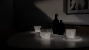

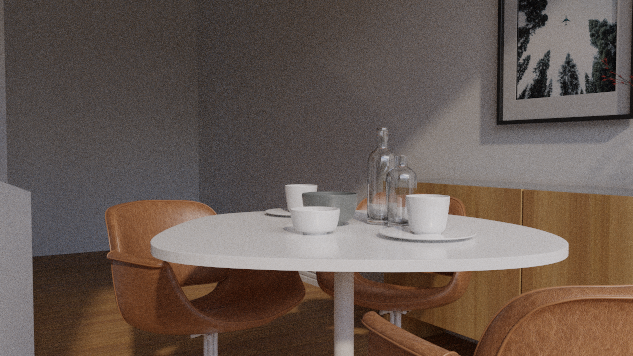

I've not looked into your file yet but this problem appears in all my animation attempts too.
example
Light tracing is not consistent in animation, the caustic brightness is always varying to different degrees depending on the scene.
It may be caused by the metropolis algorithm finding paths with different efficiency in every other frame or a floating point precision problem when the caustics cover a small area compared to the scene bounding box (issue#312).
Sun and sky is always more problematic than lamp lights and HDRIs are worst in this respect.

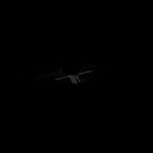

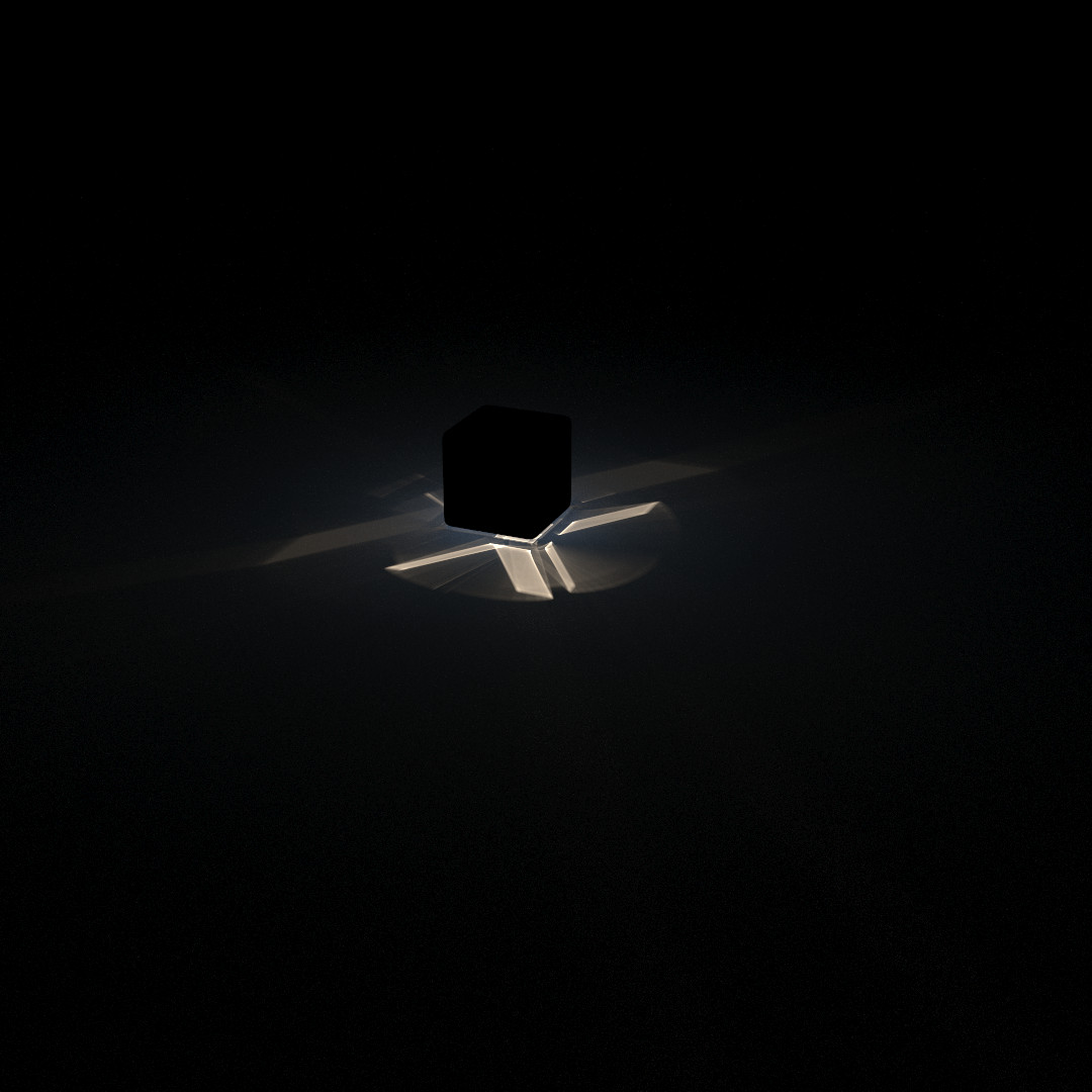

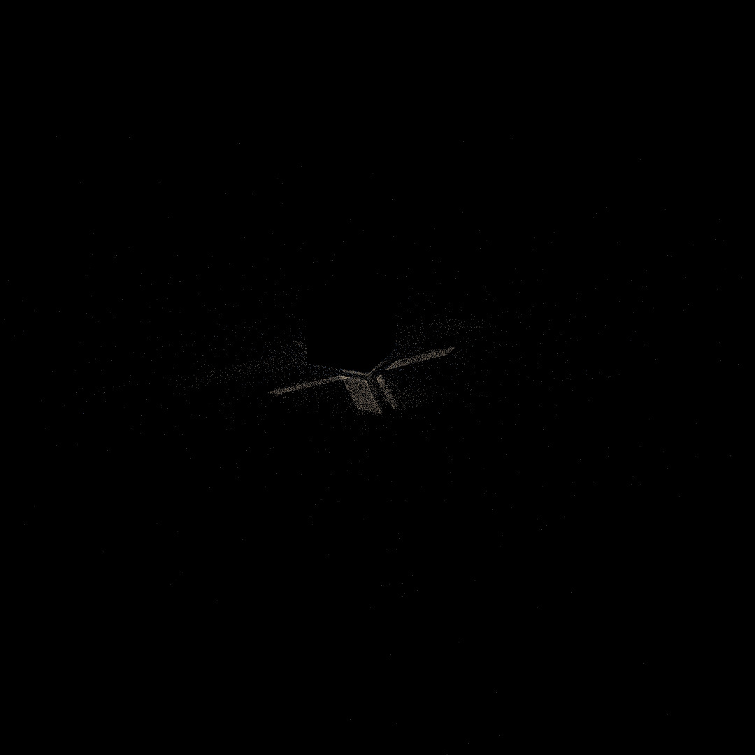

I'm able to reproduce the problem here, the frame 54 (and 58) is fine (caustics only rendering):
while there is a jump in brightness in frame 56:
I'm checking what is going on.

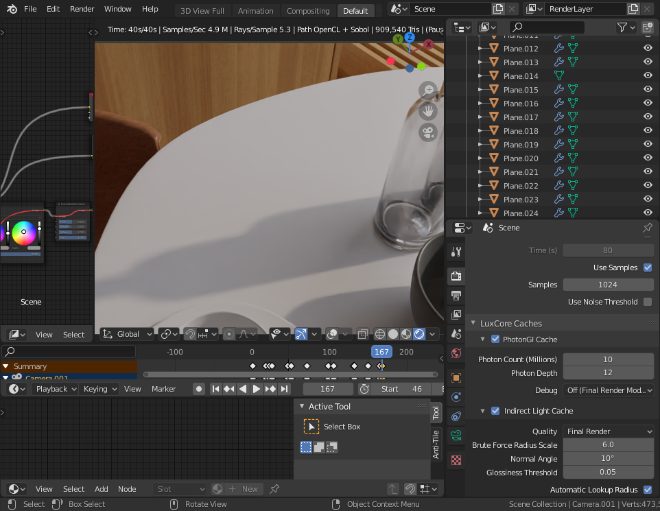

Thank you for the explanation. But what is the solution to this? No light tracing for animation in this case?

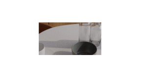

When I use caustic cache instead and make it persistent, I get flickering, too.
But when I don't use the persistent mode, I get a flickerfree version.
https://streamable.com/ygoi9r

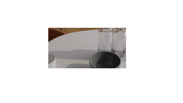

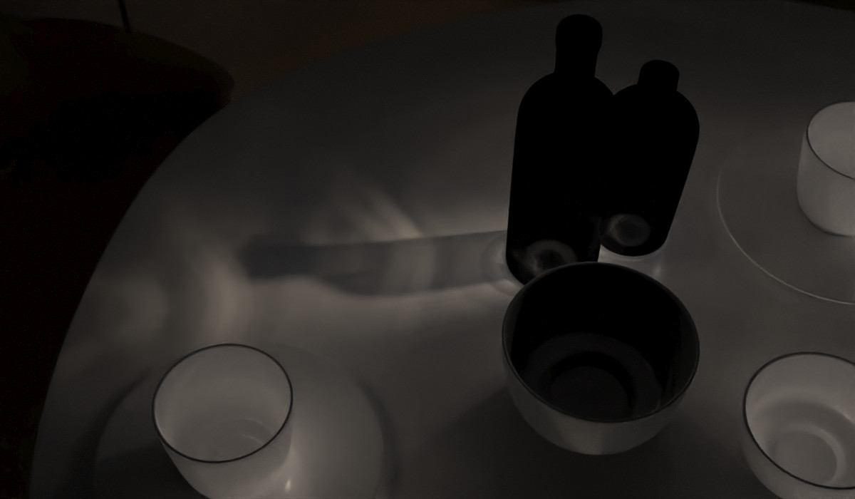

But you can see the cache in the image, mainly on the black bowl. So I decreased the lookup radius of the caustic cache and made it 10 times smaller and the result I get with a value of 0.0005 m is good.
It takes forever, almost 10times. And this is just a 1/3 of the resultion. So at the end 1 frame will take 10min*3*3=180min. Uhh.
Do you have any caustic setting tips?
Nonetheless, the caustics of the glass bottle are very weak

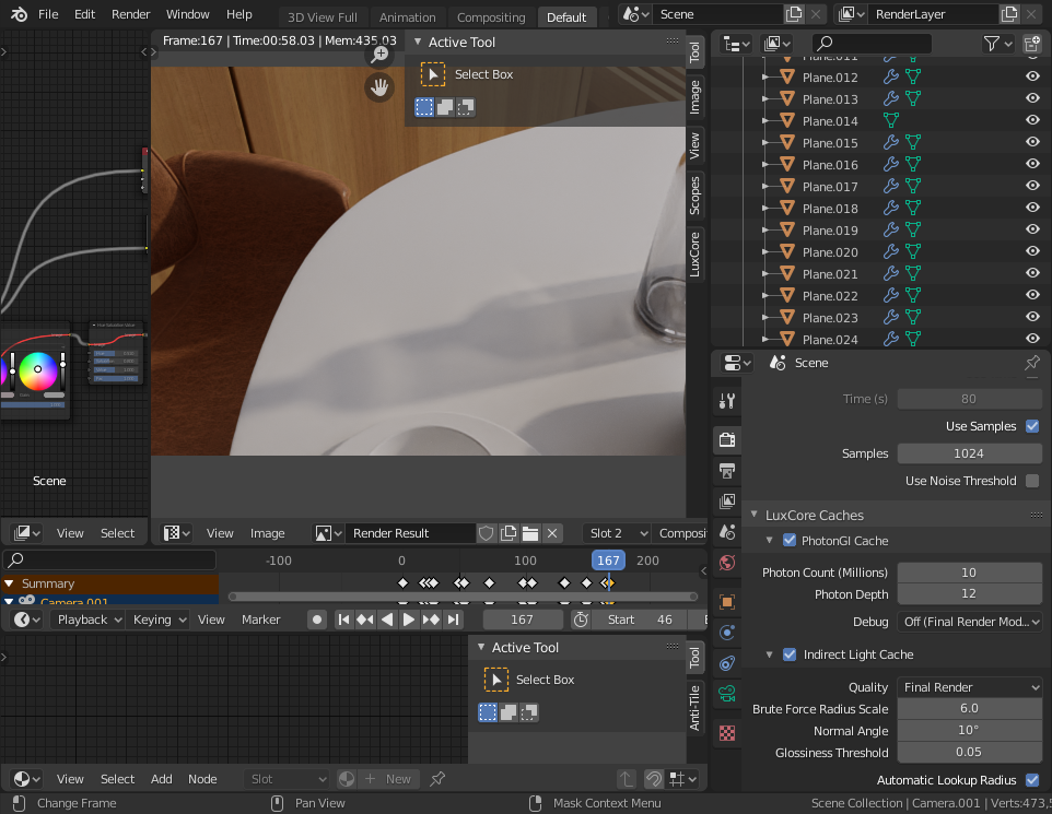

The flickering is way better, but there is still an increase of brightness. It feels more linear.
https://streamable.com/411d7q
But what I miss are the refractive caustics. Light tracing and PhotonGI ind. cache is on and persistent.
Here is the old flickering version:
and here the new version:

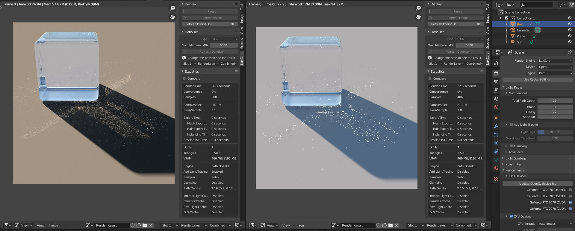

Re: The flickerfree animation challenge
mischterlampe wrote: Thu May 07, 2020 6:11 pm But what I miss are the refractive caustics. Light tracing and PhotonGI ind. cache is on and persistent.
I should I have fixed this problem too:

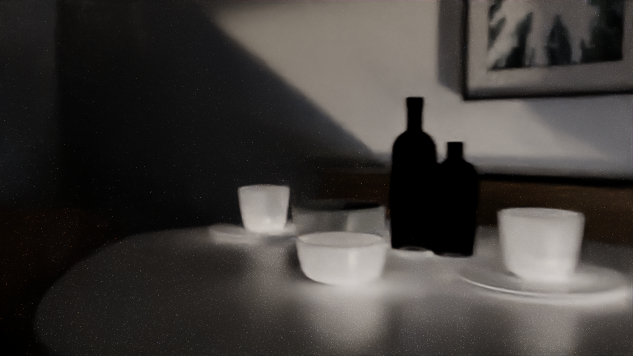

About the flickering, there are 2 problems:
1) the halt condition is currently based on the sum of eye (GPU) and light (CPU) samples. Clearly if your GPU(s) is fast enough (and/or the CPU is slow enough), you can end rendering only (or nearly only) eye samples in a short rendering.
2) Metropolis has a warm up period and is unbiased on the long run. This mean that an early stage of the rendering can look quite different from a long run. This is an early stage:
and this is the long run of exactly the same rendering:
The perceived brightness of the 2 images is clearly different but there is nothing wrong, it is just a large initial error (aka noise) that is reduced on the long run.
Clearly, problem #1 can exacerbate the #2.
So, my theory is that flickering, with the very latest version should disappear more samples you render (i.e. if try to render the animation with a lot more time per frame, it should disappear).
I have some idea to alleviate the problem but the end result is still you need to render more time per frame (they takes about 20secs on my PC).
