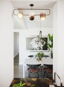

Right now Im testing the interior scene I have to solve the problem in the best way I can
ELC.zip
Set Env. Light Caching Quality to 1.0. This should help.
Just a short render test:
Env. Light Caching_CPU, clamp 0.1, 256 samples, 0.75x, env. light q. 1.0.png

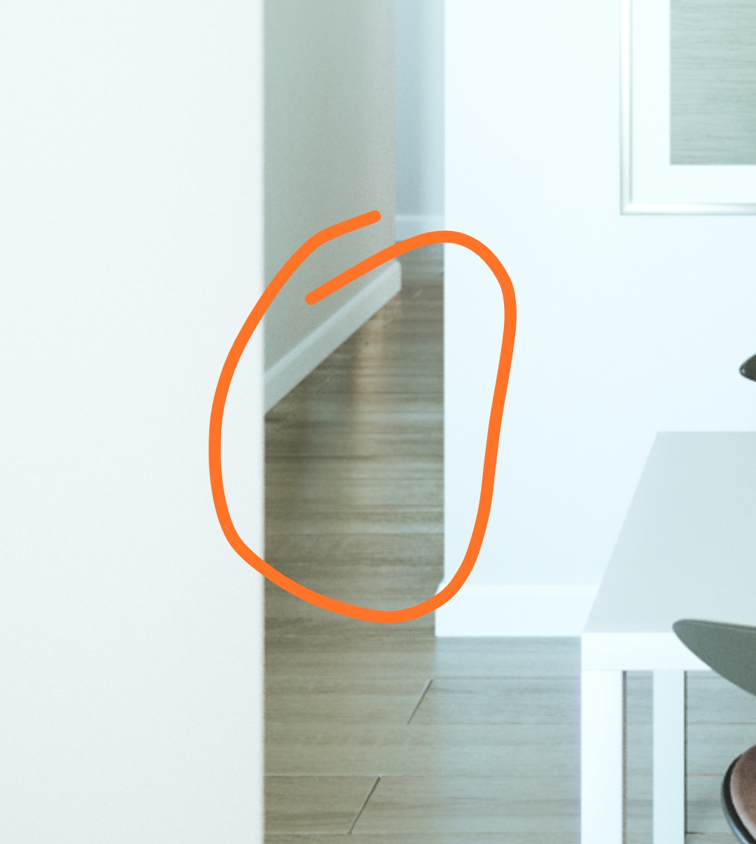

lacilaci wrote: Wed Apr 15, 2020 6:26 am
Try using higher clamping values... These spots tend to show up mainly with low clamping.
There are also cases where they show up no matter what (dense structures etc) and then there is no help.... But in your case it does look more like a clamping related issue
Thanks again Laci, I think now I know how to deal with it hahaha
Great, render looks nice but now there is another issue to solve...
Try disabling "use cache" on your flooring material. You should still get good performance but floor won't reflect strong indirect light cache spots.
Unfortunately, indirect light cache isnt clamped at all, so when cache stores very strong light, it can be reflected on materials.
lacilaci wrote: Mon Apr 20, 2020 8:03 pm
Now I get a light on the beam, I could only get rid of it by disabling the indirect light cache, it is not so annoying, so I can leave it like that for now hahaha but I will be testing it later to see how to solve it
