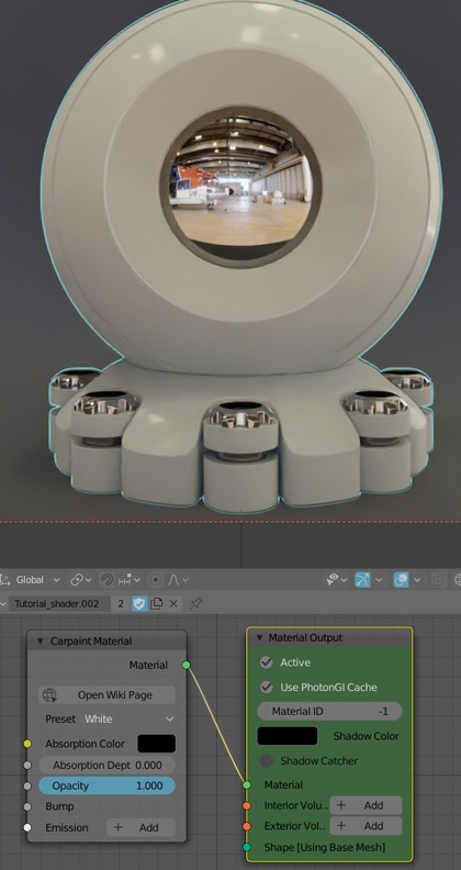

Just look like carpaint shader is broken. It is emissive even in low light condition.

Yes, using pure 100% white Specular channels can do that.
For reference check Carpaint's Preset: "White" to get to see it physically-based.

+ protip: I also strongly advise use of LookDev accessories (colorchecker, gray & mirror ball) for lighting or CC/TM reference and later calibration with Material tests/study scenes. You know, like real pro... ;)

Ahh don't even noticed it. but this is not good like this. i mean theses are preset : preset should not be confusing like that. :(
As user you always feel like error come from you. because you're facing preset.

That's why "protip" seemed in place ;)

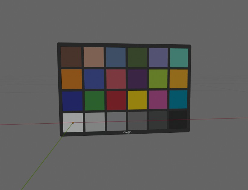

I happen to have color checker:
color_checker_282.zip
(111.69 KiB) Downloaded 366 times
