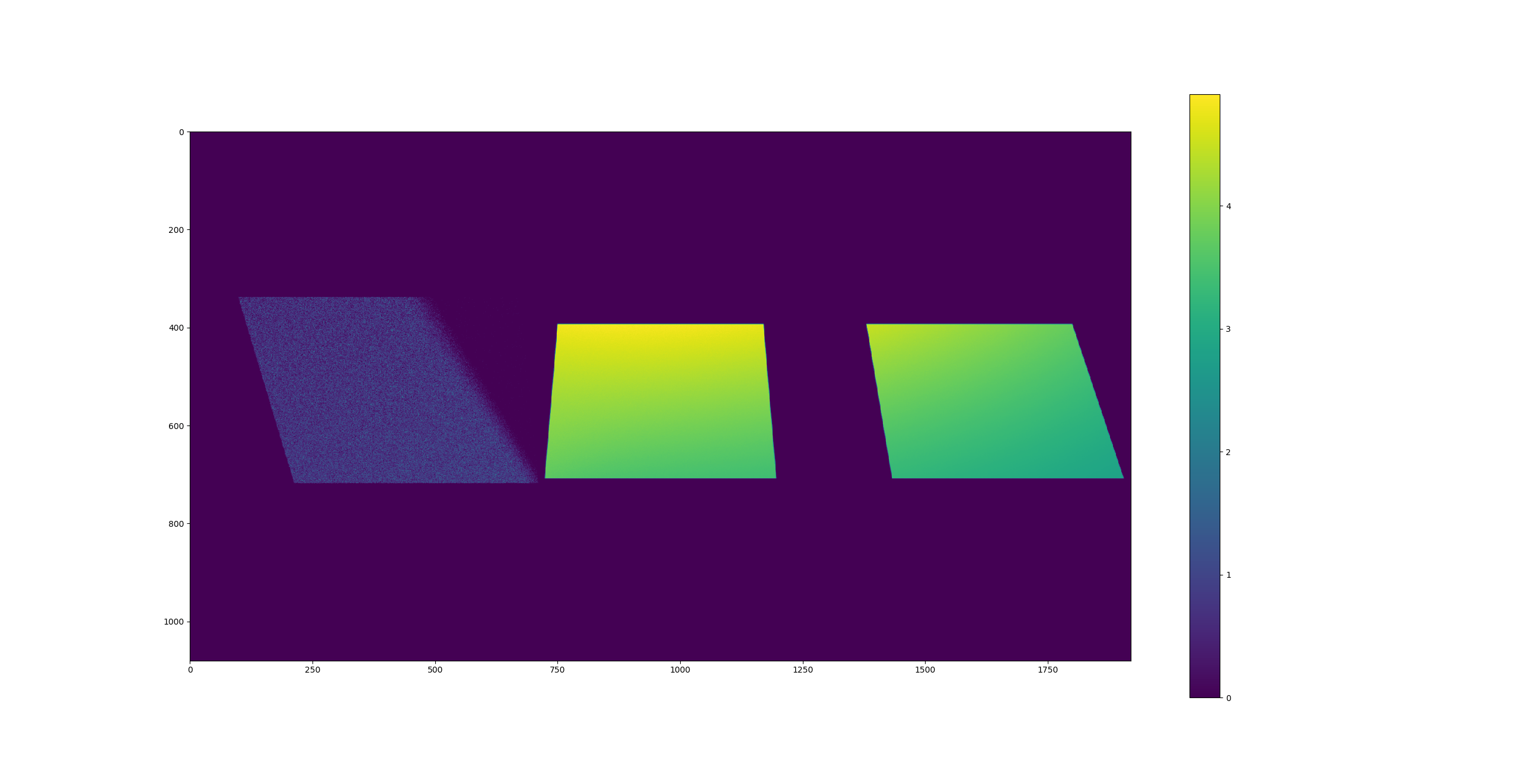

I just had a brief look at the depth channel, since i find this an interesting topic, too.
I set up a simple test scene (Attached) with a point source, camera and three matte planes. Two are angled up to the light source, i.e. a single bounce to the camera, the other is angled down and receives light via a mirror.
Using hybrid path, this is the depth AOV I get. Saved to exr and displayed with python.
The values do not make sense to me. No matter if if is camera to object, light to object or total sum, the value should get bigger towards the bottom right, not smaller. The units also don't seem to refelct the distances.
Dade, can you clarify what depth AOV is supposed to show?

Re: Using LuxCoreRender for Radio Frequencies
CodeHD wrote: Fri Apr 03, 2020 1:32 pm The values do not make sense to me. No matter if if is camera to object, light to object or total sum, the value should get bigger towards the bottom right, not smaller. The units also don't seem to refelct the distances.
You are using light tracing only:
path.hybridbackforward.enable = 1
path.hybridbackforward.partition = 0
It doesn't make any sense (how can LuxCore estimate the distance from the eye ... if it doesn't trace eye paths at all !). It is a trick to to have something similar to a caustic AOV, nothing more. Just disable light tracing or trace some eye path at least.
Posts: 520
It's the same with 50% ratio and also with pure path tracing. Only that the third plane is not visible at all in the latter case as expected.
Also, I was doing it with OCL, so the light tracing only should have affected only CPU, no?
In any case, you are saying that depth-AOV only gives the distance between camera and first object intersection? In this case, I don't think it would be what mattia needs.
CodeHD wrote: Fri Apr 03, 2020 1:58 pm In any case, you are saying that depth-AOV only gives the distance between camera and first object intersection?
It is the very same definition of Z-buffer, what else could it be ?
P.S. it is the distance between the image plane (not the camera) and the first object intersection.

Posts: 520
Dade wrote: Fri Apr 03, 2020 2:38 pm It is the very same definition of Z-buffer, what else could it be ?
The question was if it could be integrated ray distance (as amttia asked for), but I didn't think as far as that it would not make sense, or at least not universal, for infinite light sources (Sun, etc.)
But even with the z-buffer to image plane definition, it does not make sense that there is a left-to-right gradient in the depth.
