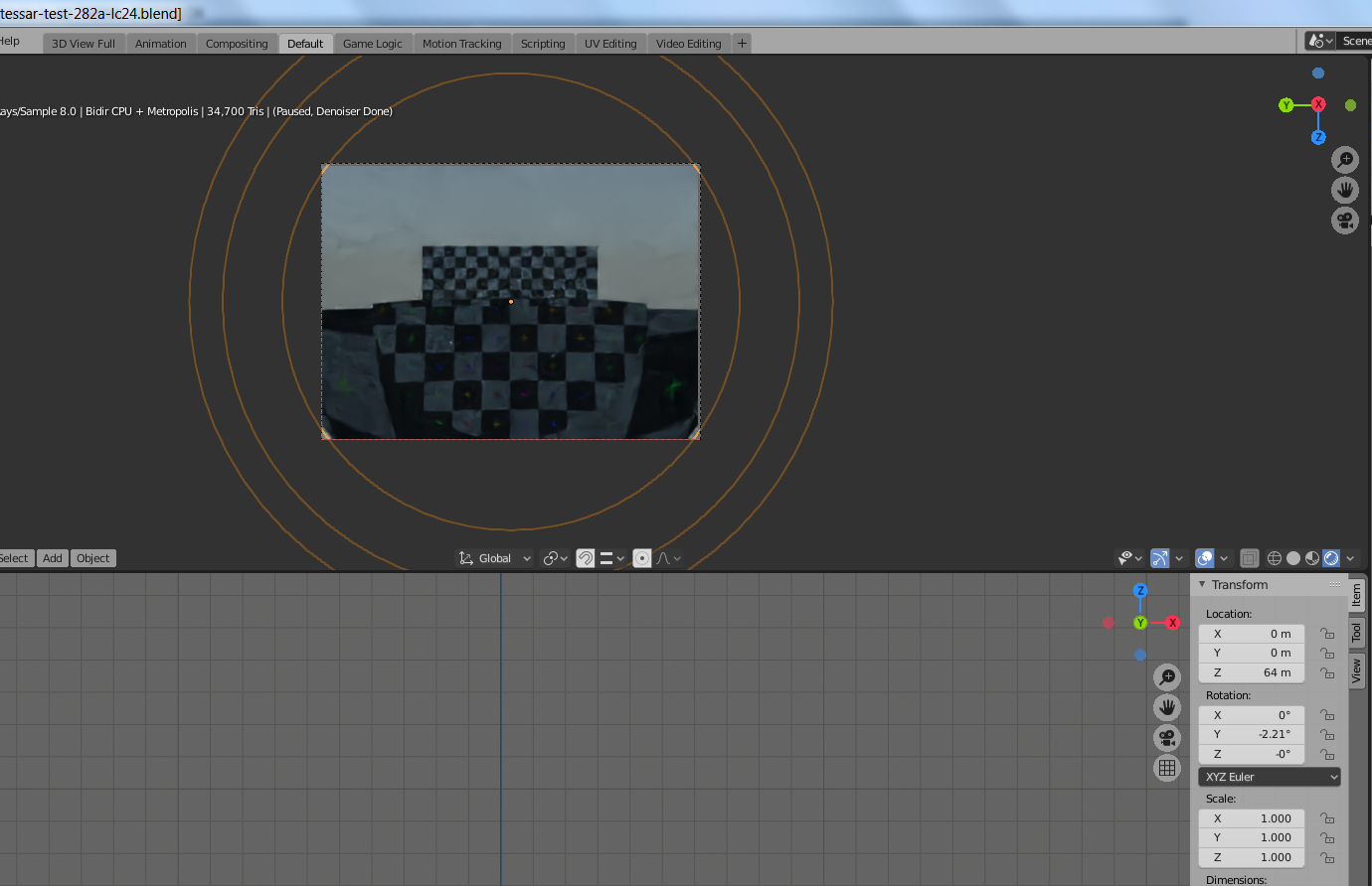

If camera is higher than 64 meters (my scale is 1.0, so it is 64 units) above XY plane and lower than 256, then it behave badly and mistreats lenses. See that zoomed in circle in the center, it should not be.

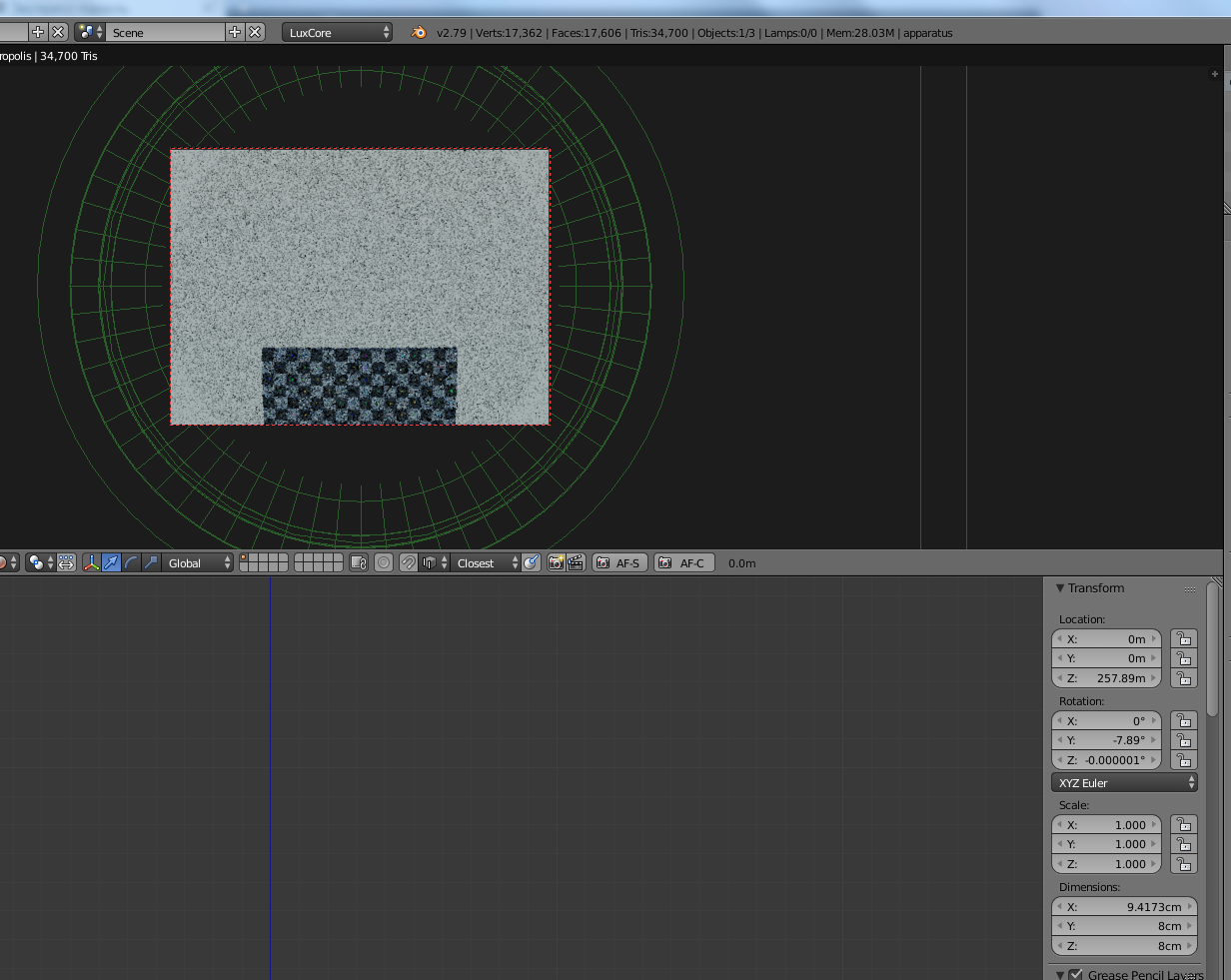

And a little further z than 256:
I think this also happen with negative z values.
upd: in a scene with unit scale 3.0, its 17 meters where camera produce that circle.
upd2: there's some complex correlation, numbers 64 and 256 seems to be valid only for attached scene.

B.Y.O.B. wrote: Mon Mar 30, 2020 8:41 am The addon for Blender 2.79 is no longer maintained. Does the problem also happen with Blender 2.82a?
Yes.
