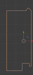

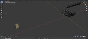

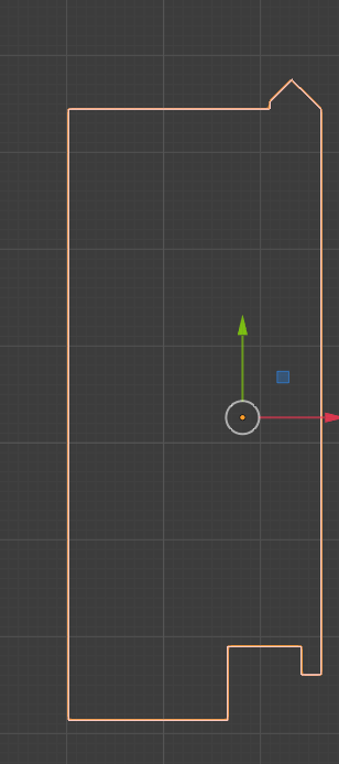

Probably also in the heavy scene I've sent and that you checked before, there is a mesh with a particle system to make fur for a carpet.
It should have this shape It's near a cube with an empty object called "UV_Tappeto_Interface...."
If you remove the particles from the viewport render, it render fast as GPU can (1M samples/sec with out env cache, 2,2M with env cache on)
And, probably the standard rendering was faster with GPU cause the particle system was disabled on rendering (camera icon on particle system off)
Probably I've found what slow down everything.

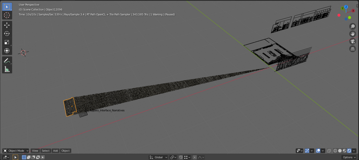

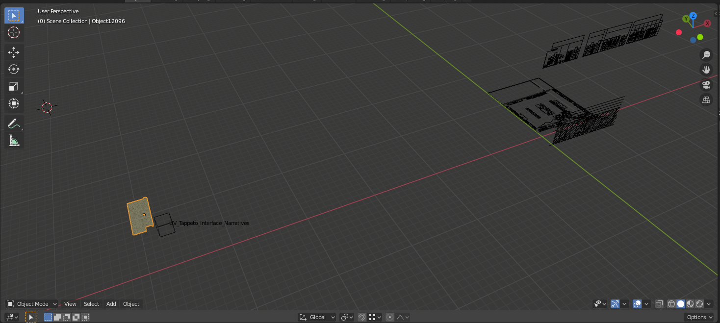

I have tracked the problem down to one rug with a hair system.
It seems to be the sole object responsible for the slow rendering (when I hide it, the viewport runs fast).
It looks to me like there's a bug in our hair export, which causes the hairs to be generated from rug surface to world origin, creating very long strands. I created an issue for this: https://github.com/LuxCoreRender/BlendL ... issues/408
