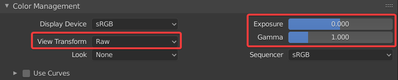

lighting_freak wrote: Wed Mar 04, 2020 8:09 am Is there an option somewhere in the tons of Blender menus that allows me to read those raw values? I really don't see an option there to read the numbers.
In the render settings, under Color management:
Then disable LuxCore tonemapper in the camera:
In the viewport, values above 1 will obviously be clamped to 1. You can use LuxCore Linear tonemapper to multiply that value down: Pixel brightness = Luminance * Linear Tonemap gain.
If you start a normal render, the Image View has a Sample tool that will allow you to vizualize unclamped values (hold left click over the image)

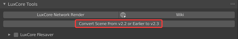

2.3 adds new light units and didn't remove any. There are difference with 2.2 if you were using Power and Gain. In 2.2, Power and gain was automatically normalized by color luminance for the Emission node (but not for lights!). In 2.3 this will be turned off by default, with the option to turn it on yourself.
This is to fix the previous behavior that somewhat assumed that Power was a photometric unit.
There will be a button at the bottom of the render tab to convert the scene for you:

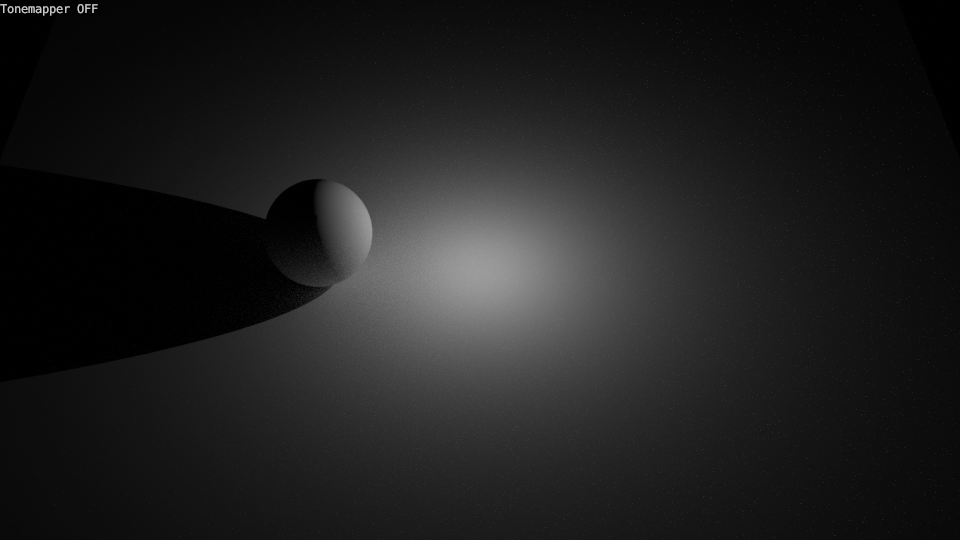

Same scene in LuxCore, with no Tonemapper:
It matches fine, all good here.

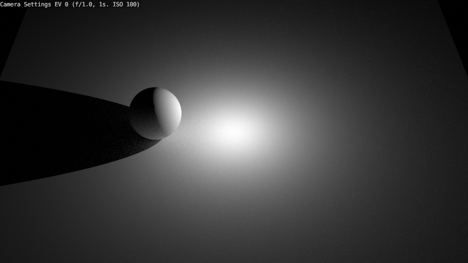

Then using a Camera exposure of EV 0:
The image is 3 times brighter, which is an exposure difference of 1.6 EV. This doesn't seem correct. In Unreal the difference between using q and not using it is a 0.263 EV difference, not 1.6.
