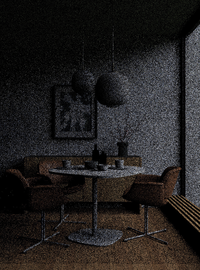

An 1 samples/pixel without any cache (only importance sampling):
An 1 samples/pixel with old Env. Light Visibility Cache:
An 1 samples/pixel with new 2 levels Env. Light Visibility Cache:
Note: all 3 methods are unbiased and converge to the correct solution on the long run.
