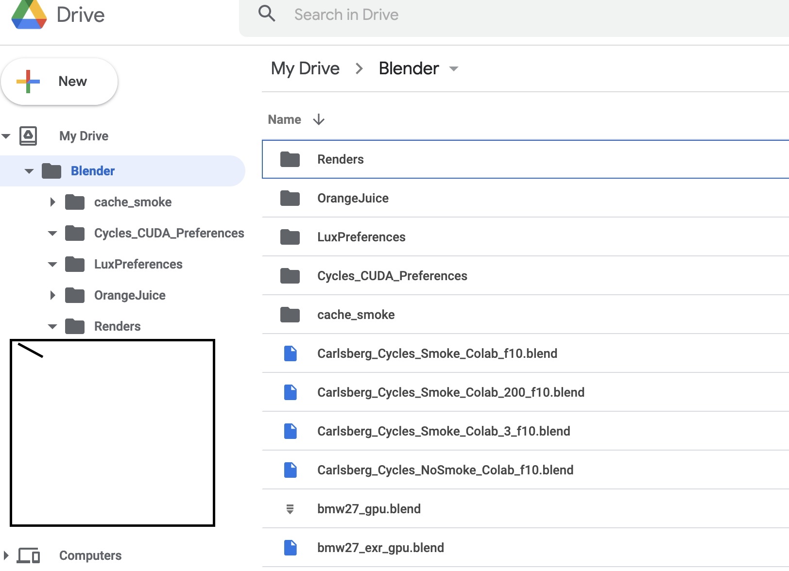

This is my hierarchy, all files to be rendered in Blender main directory:
Render will assume all settings done in file.
Point to file and render, like in last steps of the Colab.
