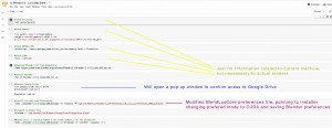

The Colab contents are as follows:

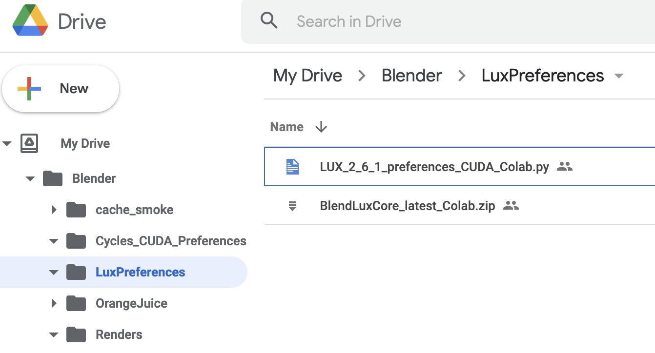

The preferences file (one might need to edit the path inside fileto installer if placed on a diferent folder) that points to installer,chooses CUDA and exits Blender saving preferences:
https://drive.google.com/file/d/1jCLXN_ ... sp=sharing

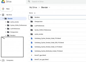

The usage is quite simple, I recommend you keep everything in the same folder in Google Drive, mine is Blender but feel free to customize.

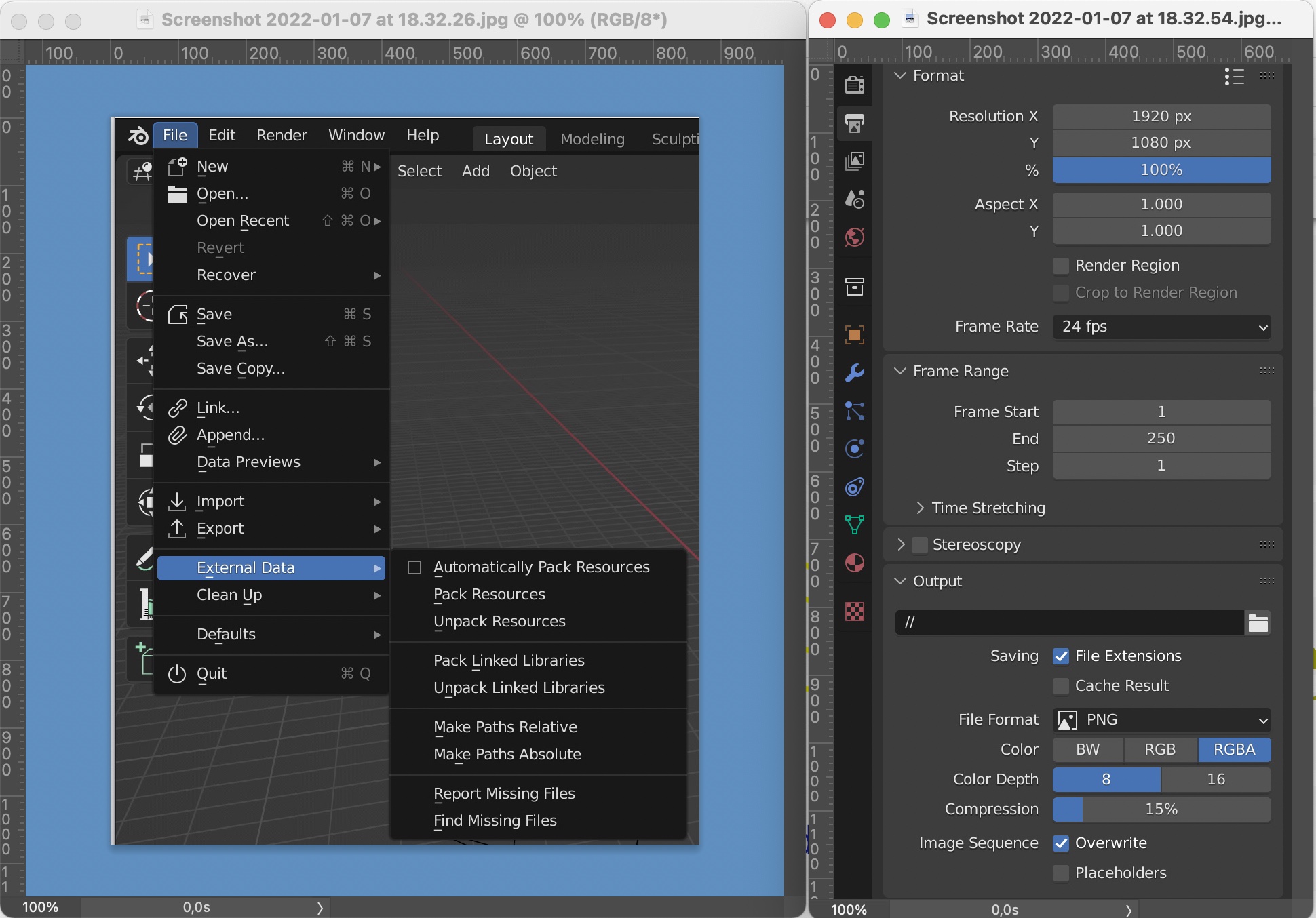

For simplicity and ease of use the best way is to set EVERYTHING on file so:
-Pack resources and keep the Automatic
-Keep path relative
-Keep outputs relative ("//" or "//Renders" for instance if you want to have them in a folder Renders place above file.blend directory)
-Same for simulations, keep a folder ins same file.blend directory named "sim" or whathever and point path to "//sim"

This is my hierarchy, all files to be rendered in Blender main directory:

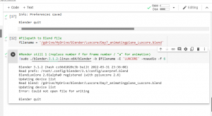

Help me fix this. This is the same case with v3.0
Re: How to Install Blendluxcore for Blender on Google Colab
I fixed this I forgot to follow the automatic pack resources and output past now it is rendering, thanks alot.

It will output whatever and wherever is setup on file, by default is tmp directory, change that to a meanfull directory or keep it relative to file (//). Also change whatever layer passes and file format output you want, save and re upload file to Google Drive.
