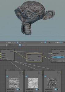

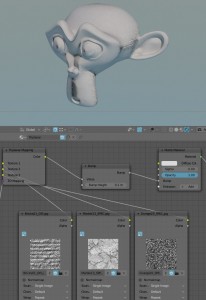

Posted: Tue Jan 14, 2020 4:56 pm
by kintuX
Dade wrote: Tue Jan 14, 2020 3:44 pmSo, does it work ?
Suzanne looks OK.
Q: Is there any control to manipulate the overlay blending like it can be done with Cycles (Blend value)?
ie
Edit
Ah, the Bump seems to have no effect where textures blend.
- Bump only
- Bump + Diffuse

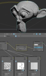

Edit2
Used another, different set of textures from
CC0textures & well, this time everything looks OK.
e.g.
- Bump only
