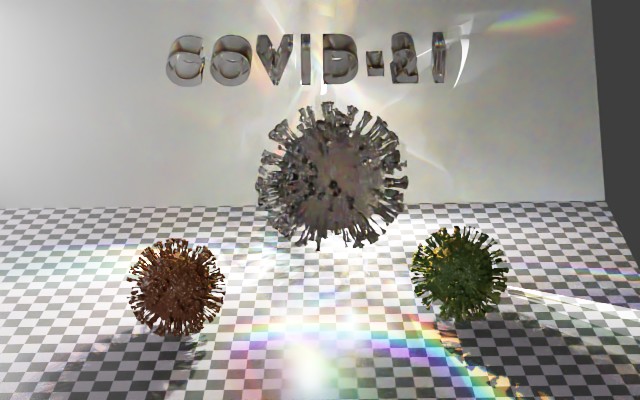

Here is a
Luxcore Testing Scene.
But i think any complicated Scene will do.
PS: It shows my new ugly Covid-21 Virus.
Has anybody a nice electron-microscope-texture for Luxrender?

I checked out the Underwater Paintigs from luxcorender.org/example-scenes/ and indeed, when rendering Tiled, caustics do not work.
I think this is very important for jewelers.
