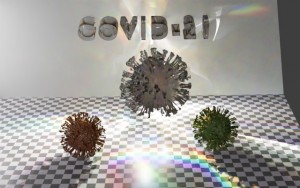

Here is a Luxcore Testing Scene.
But i think any complicated Scene will do.
PS: It shows my new ugly Covid-21 Virus.
Has anybody a nice electron-microscope-texture for Luxrender?

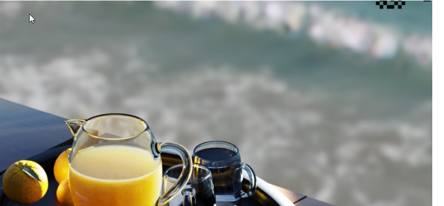

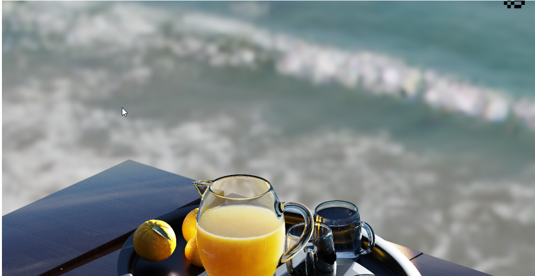

1. Get artefacts on the upper right border
2. Render window is nearly unresponsive
3. Sometimes just stays black
4. Sometimes just stops rendering
You can try:
So i recommend that you take the Orange-Juice-Sample-Scene from here (Sample-Scenes) and render it with a resolution of 10200x6800.
Try to resize the renderwindow.
Try to render it for 2-3 hrs.
How does it look?
At this point it does not matter wether i use Tiled or normal Sampling.
To me looks that such Hi Resolutions currently overrun the Luxcore?
@Sharlybg, you are a pro who know which buttons to press. Its a bit like "Bruce Lee for Lux-Render". You are trained and me is Novice.
So i need much longer for the same Opponent :-).
Artefacts on the upper right border see here:

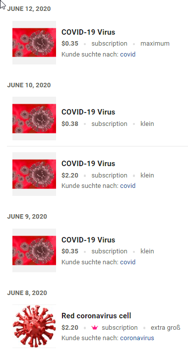

You may ask, why I am interested in this resolution.
Ok, to get the money for my electricity bill back, I upload some of my pictures to dreamstime.
On lucky days people buy these. See here:
So in case someone here also wants to get electricity-costs from rendering back (its just few Bucks per month)
you can also register @Dreamstime to upload your pictures.
I have uploaded Viruses in all colours but only the red one get sold.
So if you upload a virus i tend to say "paint it red".
And yes the best resolution for DT is the 10200x6800 (70 MP).
