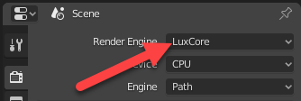

In Blender
1. Choose luxcore engine in render properties
2. Check alpha in view layers properties
3. In compositor conect the second alpha node of the render layer image wiht the alpha node of the composite.
4. Render
