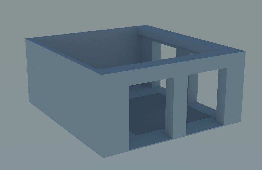

I'm testing out blendluxcore but in viewport and render some meshes are missing/invisible, I have check scale, visibility, material opacity, face orientation and no luck.
Is this a known issue?
I'm on B4.5.3 and addon 2.10.1

not an issue known to me and not obvious at first glance.
I can see that it works again if the material is deleted from the object and a new material is assigned.
I also see, using the filesaver option, that the mesh doesn't get exported at all (including material in the scene file). There is no message in BlendLuxCore logs.

Geo is still there, it's just 'bad' material (invisible). Likely got corrupted in the process. As noticed, make new one.

Thank you guys for the hint, now I can keep testing the engine.
