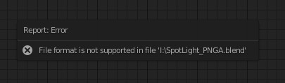

I was unable to open your blend file.

File was made w/ B3D 3.3 alpha & BLuxcore 2.6.1 daily
Simply post yours...
