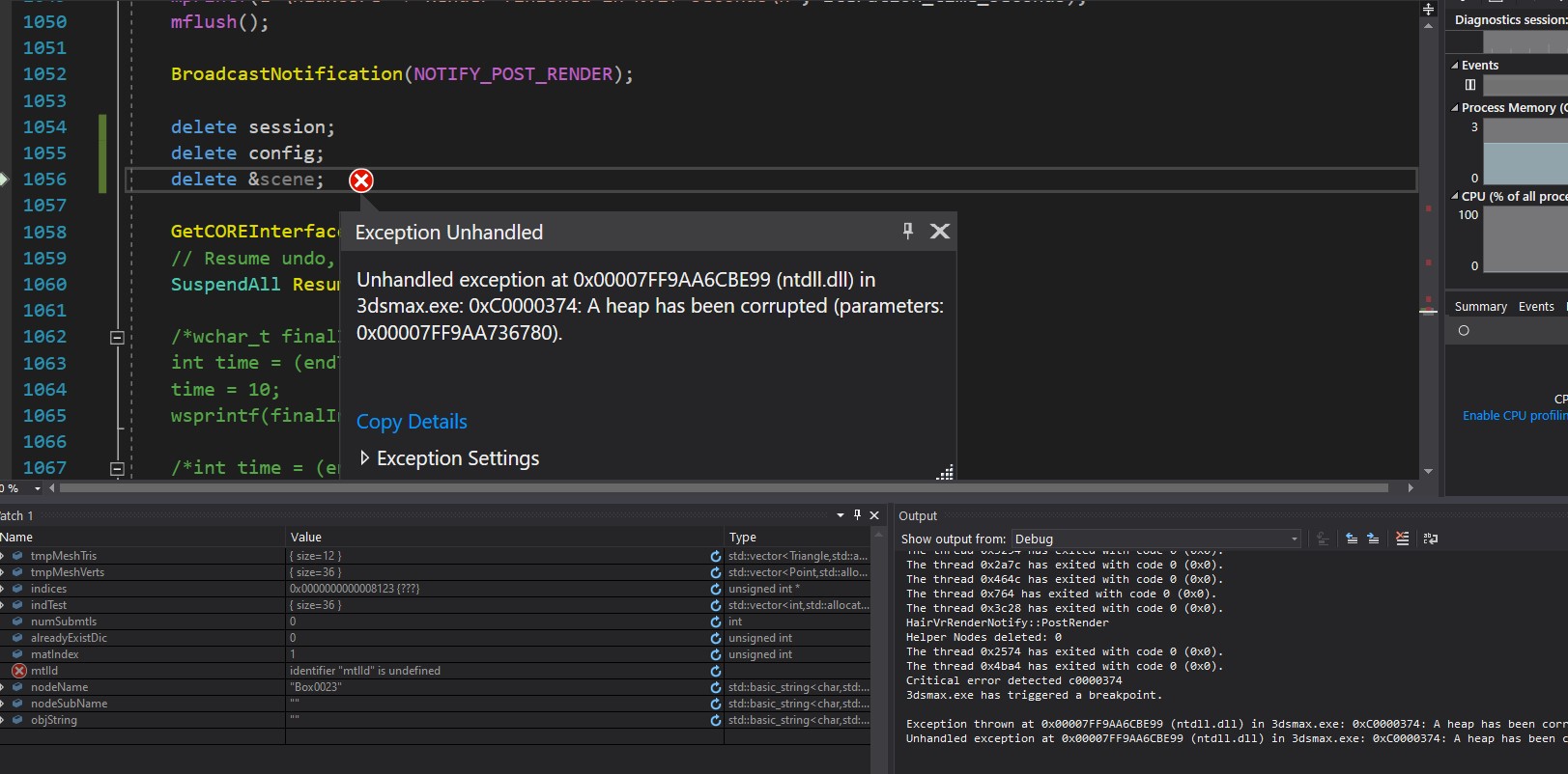

I noticed if I cancel the render too quickly normally before 50 passes 3dsmax will crash and the compiler will show me the error about "a heap has been corrupted" with a pointer on Luxcore::Scene and critical error number C0000374. The problem will appear just if I cancel the render too quickly or hit the render too many times. By the way, after 100 passes or so, never happened.
Not sure if this is related or not but if I compile all the codes with the optimization /Ox switch the problem will be less likely to happen and most of the time I will get no error at all.
here is the actual error in the compiler that may be useful.

You are deleting objects in the wrong order. You are deleting objects while they are still referenced by other objects ("config" is referenced by "session", etc.). They crash can or can not happen, it depends if the broken pointers are referencing memory that has been reused (for your process) or not.
Also the correct order is:
delete session;
delete config;
delete &scene; // NOTE: see below, there may be more
How do you create the scene object ? Are you using the RenderConfig::DeleteSceneOnExit() ?

I did not use DeleteSceneOnExit() function and changed the order of the delete session as you mention.
is the last line and after that just resume all suspension in 3dsmax nothing more.
I need to add this, the error does not always mean crash, sometimes I will see the error but 3dsmax will not crash and function normally so if I'm not in debug mode I can not notice that all the time, just when the crash happens.
