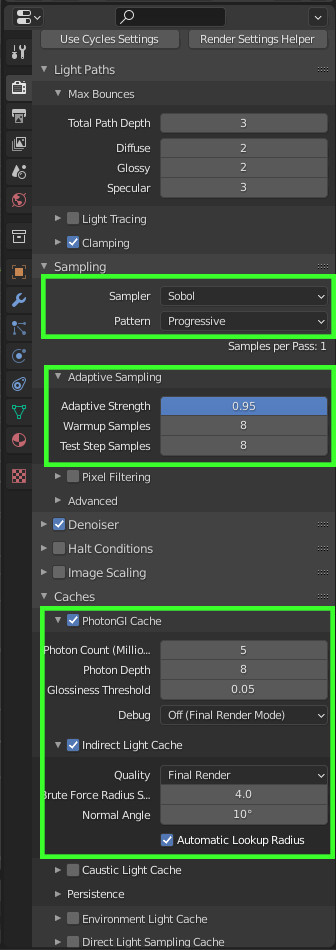

Posted: Tue Sep 28, 2021 8:59 am
by Sharlybg
That look really nice and well design.
Btw you do have a lot of performance left behind with thoses settings you just shared
For example as your are on Path tracing (not bidir) Sobol should be faster i think.
Also it is an interior with lot of diffuse surface so you can gain lot of speed through Gi cache.
Maybe you can try a test render at lower resolution to compare with settings
below :
Re: Modern Bed Room
Posted: Tue Sep 28, 2021 10:24 am
by nogay
Thanks for the comments. i will try sharlybg. dat_boi, I don't have enough material experience for luxrender yet. so cycles is still my first choice. I really like luxrender as image processing quality. The comparison image already explains everything. :)
