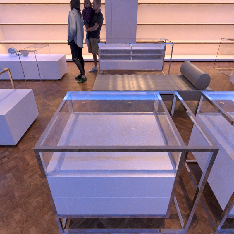

You are right.
Typical glass cage
Workaround, glass cage not casting shadows
This applies to whatever glass object which stands on a bright surface so that we expect to recognize some slight shadow+causitcs

Those are SDS caustics (specular-diffuse-specular).
LuxCore has three ways of dealing with this problem:
  • The archglass (architectural glass) material can be used, with the downside that it doesn't have refractions, only reflections. So it's only suited for thin glass sheets where refraction wouldn't make a difference anyway. In your scene, it might work.
  • So-called "hybrid glass": use a glass material and set the shadow color to white. It sounds like this is the workaround you currently use? The benefit over archglass is that refractions are visible.
  • PhotonGI with caustic cache enabled, and use regular glass with black shadow color as material. This will compute the correct caustic patterns of the light after getting refracted by the glass, but it's only really necessary when the glass surface is curved or bumpy. The downside is that building the caustics cache costs compute power and takes time to converge and it might take some trial-and-error until you get the settings like lookup radius right for a particular scene.
In general, SDS paths are a hard problem for renderers and there is not yet a simple, pain-free solution for them, as far as I know.
