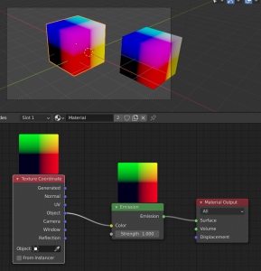

Dade wrote: Fri Jul 16, 2021 8:07 pm What are you looking exactly for ?
In Cycles it looks like below. It's a mapping with the position in camera space as the output.
Camera projection
Camera projection

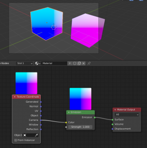

Object space projection, for comparison
