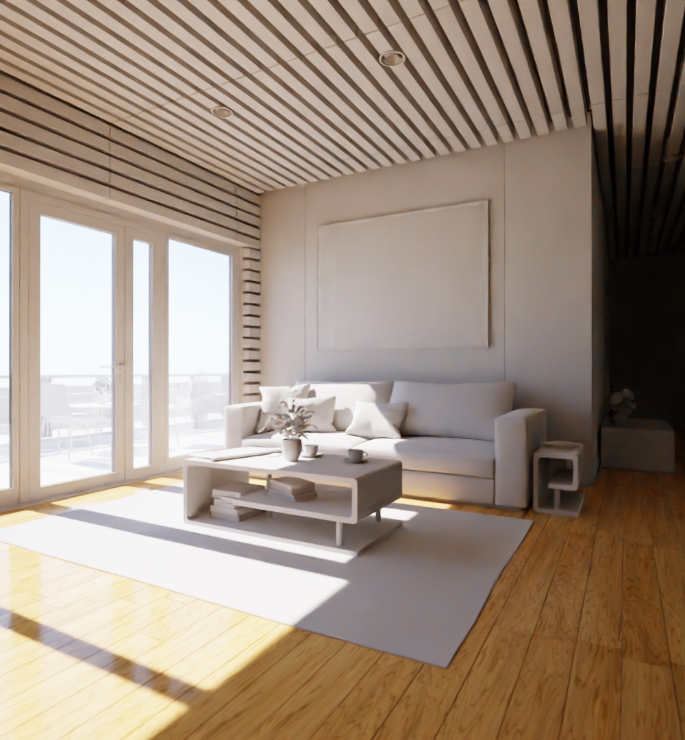

Hey Guys,
I'm having an issue with GPU rendering on a particular material setup. Basically a RandomPerIsland material for distributing floorboards. It works flawlessly on CPU rendering but completely falls over on GPU, with either OPENCL or CUDA.
Information:
Blender 2.93LTS
LuxCore 2.6 Daily (Downloaded same day as this post)
RTX 3090 (Latest Drivers)
Images:
The node setup:
CPU Render (Correct result):
GPU Render (hmmm....):

That's the same issue I see with the math node on GPU that already report in the past. With CPU there is no problem but with GPU the material going to be dark and black in some parts as you can see in your final render too.
Same behavior with 3dsmax plugin and LuxCoreRender stand-alone version.

Actually, it is a problem related to bump mapping, if you disconnect the floor bump map, CPU and GPU rendering is the same. I'm checking what is going on.

Dade wrote: Sat Jun 05, 2021 11:22 am
Exactly, it appears in bump map, and the problem will show up in GPU render and not CPU.
viewtopic.php?f=4&t=2995
I remember if I use Non-Color Data image for bump there was no problem with GPU renderer.
Re: Random Per Island/Math Node GPU Issue
Posted: Sat Jun 05, 2021 12:16 pm
by Dade
I should have fixed the problem, it was affecting Add/Subtract texture nodes when used for bump mapping. The fix will be included in the next automatic build.
