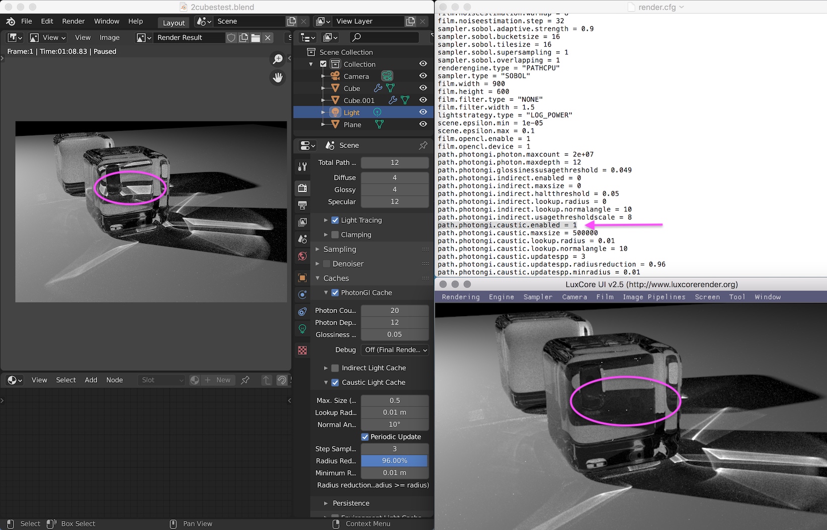

Starting to test the new version 2.6alpha I ran into a problem, with 2.6a on my Windows PC and also with 2.5 on my Mac.
Setting up a simple scene using caustic cache in Blender 2.92 works as expected, SDS caustics show up in the render.
Then I export the scene with LuxCore filesaver into text format and open it with LuxCoreUI where it renders, but without SDS paths.
Obviously caustic cache is not used though in the render.cfg it is enabled.
Is this a bug or an I doing something wrong, like the cache has to be activated somewhere in LuxCoreUI?

The problem is here:
path.photongi.photon.maxcount = 2e+07
"path.photongi.photon.maxcount" is an integer parameter, not a floating point one so this is read as "2", not as "20000000". If you look at the log, you will see as the scene is rendered tracing one single photon :!:
Looking at the code, I assume this may happen because BlendLuxCore is setting the properties as string or float (?), not as integer so it should be fixed in BlendLuxCore.
As workaround you can just edit the .cfg and write the correct number. Setting a smaller number of photon count in Blender may also work because it will not trigger the scientific notation format.

Dade wrote: Thu Apr 22, 2021 1:06 pm The problem is here:
Thanks for the explanation!
With the workaround I can now continue testing :)
