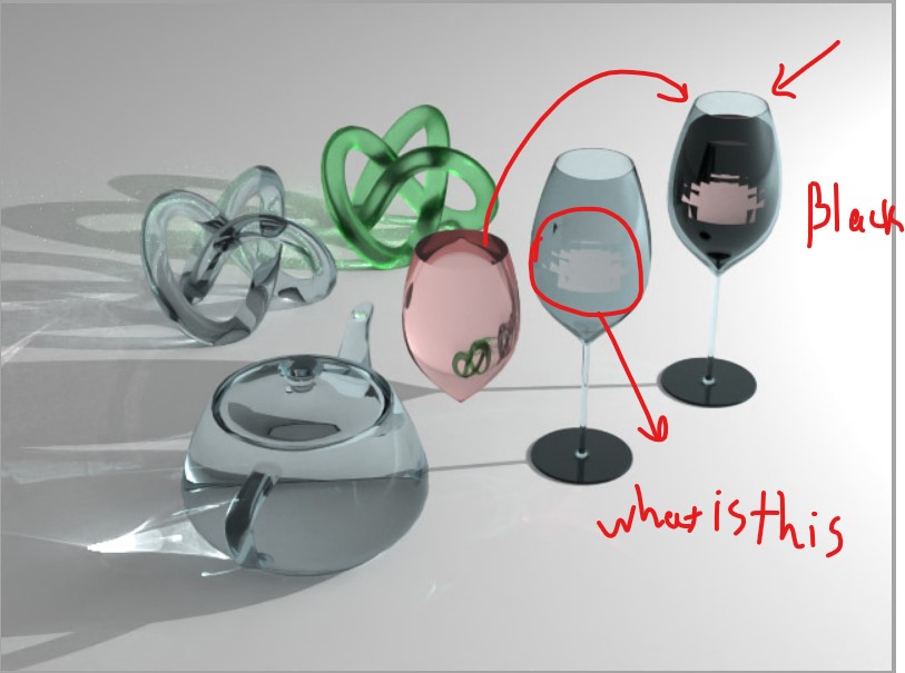

I have a problem with the glass, when i use RoughGlass caustic is much better than Clear Glass and with thin glasses, i can not get good results. is the same when two glasses are inside each other.
Can anyone put me in the right direction here?

Have you enabled light tracing (aka hybrid rendering) ? Otherwise rough glass caustics are a lot easier to render for plain path tracer than sharp glass one.
Try to use a point light: at that point caustics can not be rendered at all without light tracing.

You need to enable hybrid path/light tracing with the following .cfg properties:
# For CPU rendering
path.hybridbackforward.enable = 1
path.hybridbackforward.partition = 0.8
path.hybridbackforward.glossinessthreshold = 0.05
# Or for CPU+GPU rendering
path.hybridbackforward.partition = 0.0
The result will be (in a couple of seconds of rendering):
Notice how the rough glass caustic is noisy because it is still done trough normal path tracing (it has U/V roughness is 0.1). If you set
path.hybridbackforward.glossinessthreshold = 0.11
It will be done with light tracing too:
Hybrid Back/Forward path tracing (aka BiDir without MIS) is described here: viewtopic.php?f=5&t=1187

Great thank you i get the caustic result, what about the black color with vine when it is inside of the glass.
Also, there is a strange color in the middle of the glass.

TAO wrote: Sun Apr 18, 2021 10:44 am what about the black color with vine when it is inside of the glass.
It is an SDS, something not even plain BiDir can render. You need to use shadow transparency for the glass or caustic cache:
- viewtopic.php?f=5&t=1474 (check the orange juice glass rendering)
- viewtopic.php?f=5&t=2927 (but it can be used with path tracing too)

It is much much better and almost most part working but still, I'm not able to get rid of the black parts. Vine inside the glass and button of the glass.
that's my parameters with PATHOCL
For Material, add:
scene.materials.glass-right.transparency.shadow = 0.85 0.85 0.85
of course, i tried to tweak the parameters with no luck.
the only option that works a bit was transparency but made the vine a bit unrealistic.

Try to rise the glasses if the bottom is touching the aground plane, it can be a problem.
I assume you have already raised the path max. depth too.
