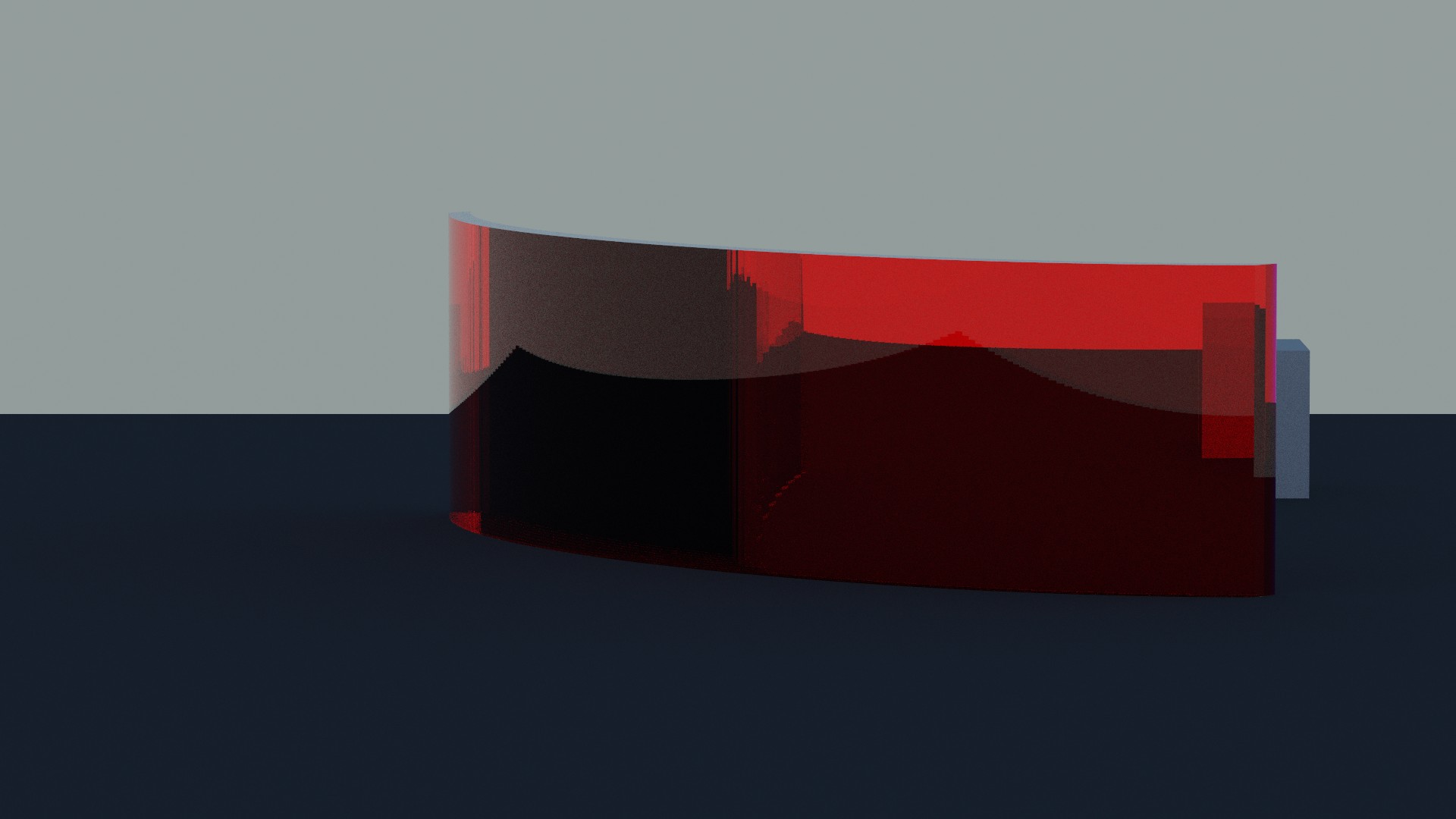

Hello all,
I've some troubles with two bodies made from clear plastics that touch each other and share a surface.
I was used to manage this situation with an intermediate surface with defined internal and external volumes.
This example shows this situation and the rendering looks wrong. The reflections are by far too high... and the optical effects too strong.
A simpl3 offsetted volume with the same thicknes everywhere should have almost no optical effect (slight shift of the image).
The volumes also share identical IOR so the reflection on the intermediate should be 0.
Test_Scene.zip
(1.63 MiB) Downloaded 2956 times
I've been looking in the face normals several times and I can't find any mistake... (tried a lot)
Also already tested, the behaviour is the same with 2.4 and 2.5 luxcore. And its also retested on the 2.83 LTS and current 2.92.0 blender.
What's wrong with this? Thanks a lot - I really apprechiate your help.
EDIT:
current two bodies result
EDIT2:
single layer only

Jan wrote: Fri Apr 16, 2021 3:41 am I cannot reproduce your single layer without image shift with your blender file
The test-scene shows my two bodies issue.
The image with a single layer shows how it should like without errors.
Having two volumes with exact the same IOR, no additional refraction should happen.
The distortion and magnification while watching through that lens should be the same with two bodies as it is with a single one (not exactly, because of translation due to higher thickness).
Hope this image shows my setup with more details and easier.
With best regards.

Posted: Mon Apr 19, 2021 1:40 pm
by lighting_freak
Hello Jan,
Hello everyone,
I appreciate your work and I really like the result of that laser beam.
The difference between the your setup and my issue is that there is no IOR difference on the intermediate surface.
Both volumes share the value of 1,492.
Having equal IOR means that there is neither refraction nor fresnel reflection on that intermediate face. Therefore the appearance of an object (the cube in my example file) should be (almost) the same with single layer and double layer volume.
Another difference is, that I don't have any scattering in my volumes, but that is not the matter of fact.
From my point of view the issue remains open.
EDIT:
I modified your scene to make it fit to the described issue.
I think the result shows exactly the problem; the refraction on the rear surface is missing.
t2_mod.blend
(996.19 KiB) Downloaded 2980 times
With kind regards.

Re: Two clear volumes in face contact
Posted: Mon Apr 19, 2021 5:47 pm
by lighting_freak
... but I don't want this tiny gap. :D
The two materials are really molded on each other (multi component molding), there is really no air gap.
If you have a closer look to the models (mine and your's modified), there are no intersecting surfaces. I erased one of those faces in one of the bodies and defined the remaining intermediate face with the internal and external volume.
Your modified model shows exactly what I could observe on my model. Last refraction intersection is missing or fails. Don't you agree?
With kind regards
