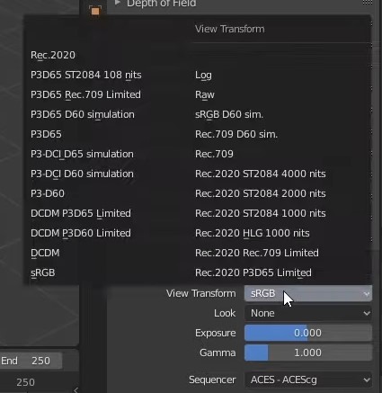

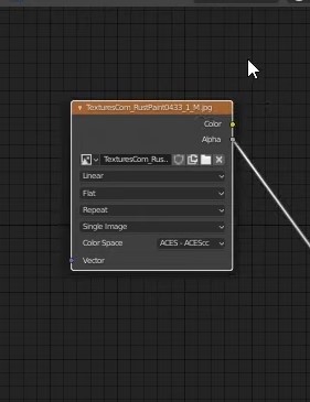

So I need to add Ocio/Aces manually in the blender and then I will be able to use it in luxcore by reading the data or Is just a single config.ocio file is enough because I already have all the Aces and OpenIO libraries available on my machine.
Because last night I start to add Ocio in the blender and I am still a little bit fuzzy here because I'm not a blender user. sorry if my questions are dumb.
By adding Aces to the blender all these options will be added to the blender and I can read them simply and purse them to luxcore. but I'm not sure if that's the correct way to and if I should add Aces/Ocio config to blender like this.
Posts: 3101
Re: Color spaces support (aka OpenColorIO v2.0)
It look exactly like what they did for blender 3.0
And Cyclesx so should be ok I think.
Great job.
