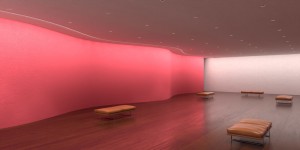

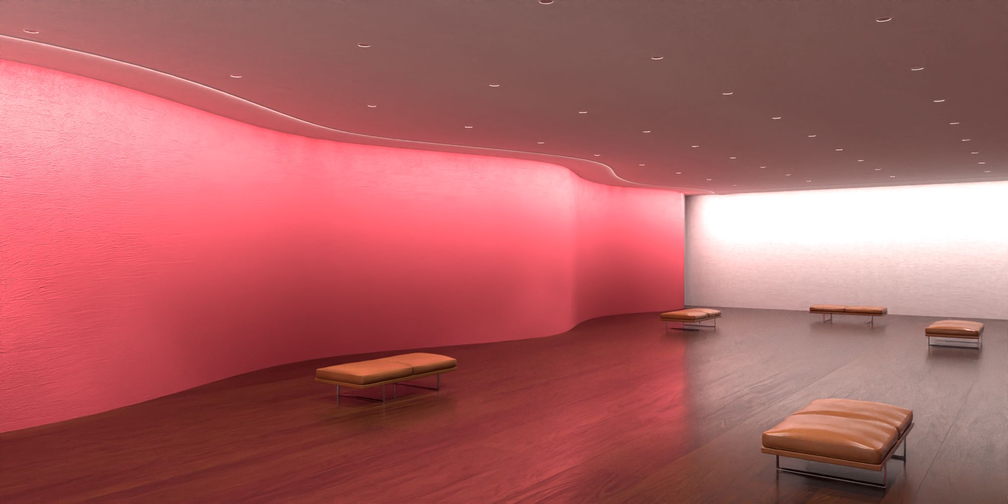

in corona it's called Highlight compression:
https://coronarenderer.freshdesk.com/su ... mpression-
in Maxwell it's called "burn", In rawtherapee and photoshop, again, it's called Highlight Compression.
I don't know if there is a standard math behind. However if i apply highlight compression in Rawtherapee to a linear tonemmapped Luxcore rendering i get something very similar to a Maxwell rendering with a burn turned on.
Luxcore lux-linear tone mapping.
Luxcore lux-linear tone mapping + rawtherapee highlight compression.
