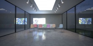

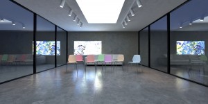

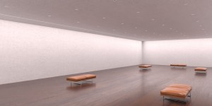

Hi, here are some of the first luxcore tests we are producing on our cloud based rendering tool, FELIX render.
Our previous rendering engine has been Maxwell Render which you can compare here with Luxcore.
All light sources are emitting about 20% direct light and 80% caustics.
As you can see Luxcore is the clear winner since caustics and indirect light are reflected correctly by the other surfaces of the scene.
Thanks to Sharlybg for helping us to set-up materials in Luxcore!
The only big issue we have is with OIDN which blurs textures details despite being feed with normal and albedo wen we use bidir+metropolis.
Luxcore 10 minutes
Maxwell Render 10 minutes
Luxcore 10 minutes
More examples to come soon.

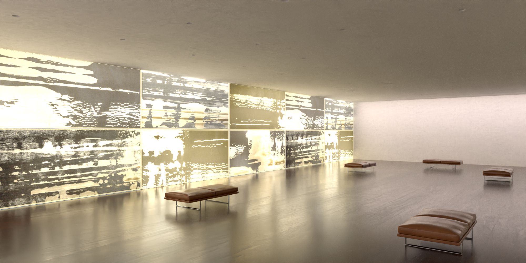

Re: LuxCore on Felix Render implementation

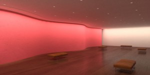

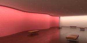

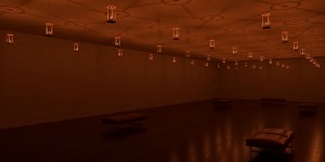

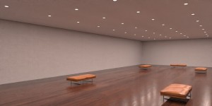

Testing lighting conditions.
Many of this set-ups are very challnenging for Maxwell but not for Lux.

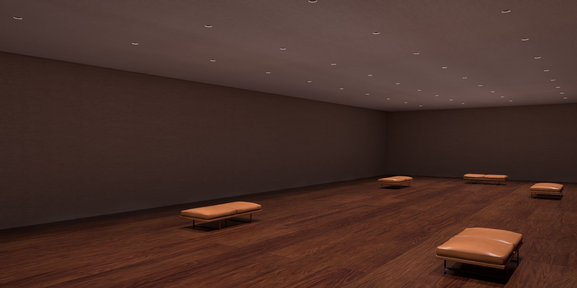

Simple recessed emitter simulating spot.
Simple recessed emitter.

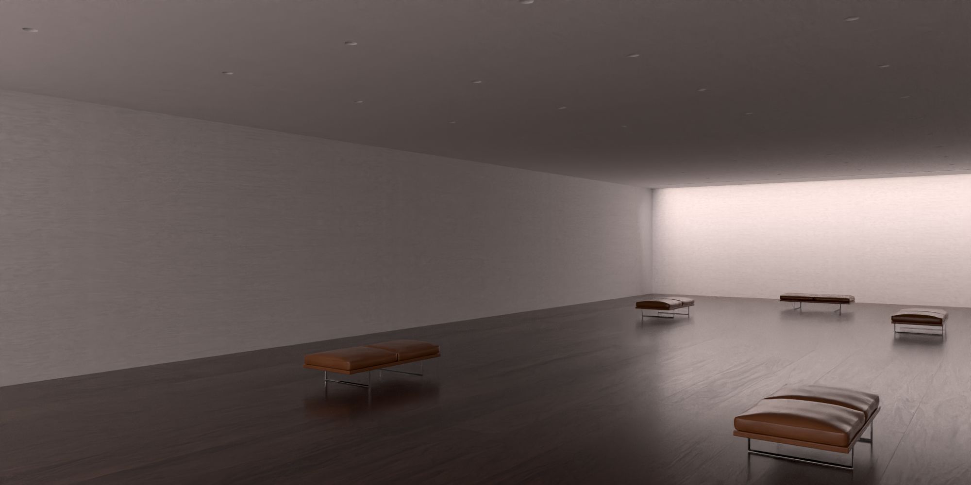

Spots 40 degree, 70%caustics, 30% direct light
Wallwasher 80%caustics, 20% direct light

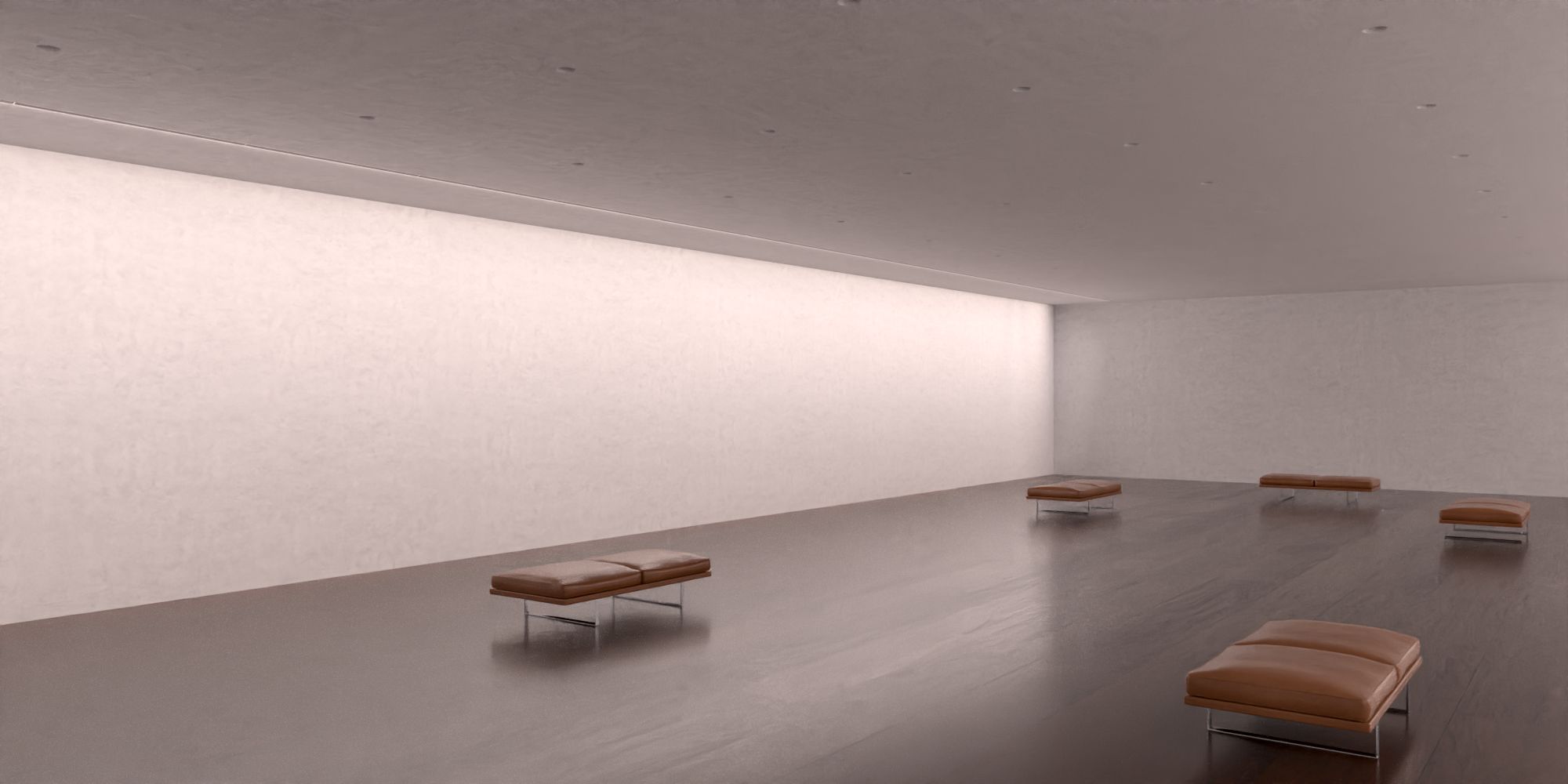

Wallwasher 80%caustics, 20% direct light + cetral spots led spots 70%caustics,30% direct light.
Light wall
Light wall+wallwasher
candle light
chandeliers
