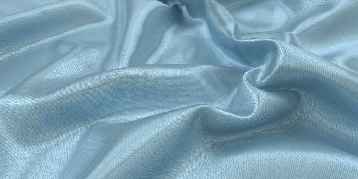

In luxcore we used two mixed metal shaders. Unfortunately we are not able to archive in luxcore the desired brillance and dynamics as in Maxwell.

Some improvement. Still i cannot match the contrast of the maxwell version. May the high anisotrpy lowers the brightness becasue the roughness-darkening issue of Luxcore?
Luxcore
