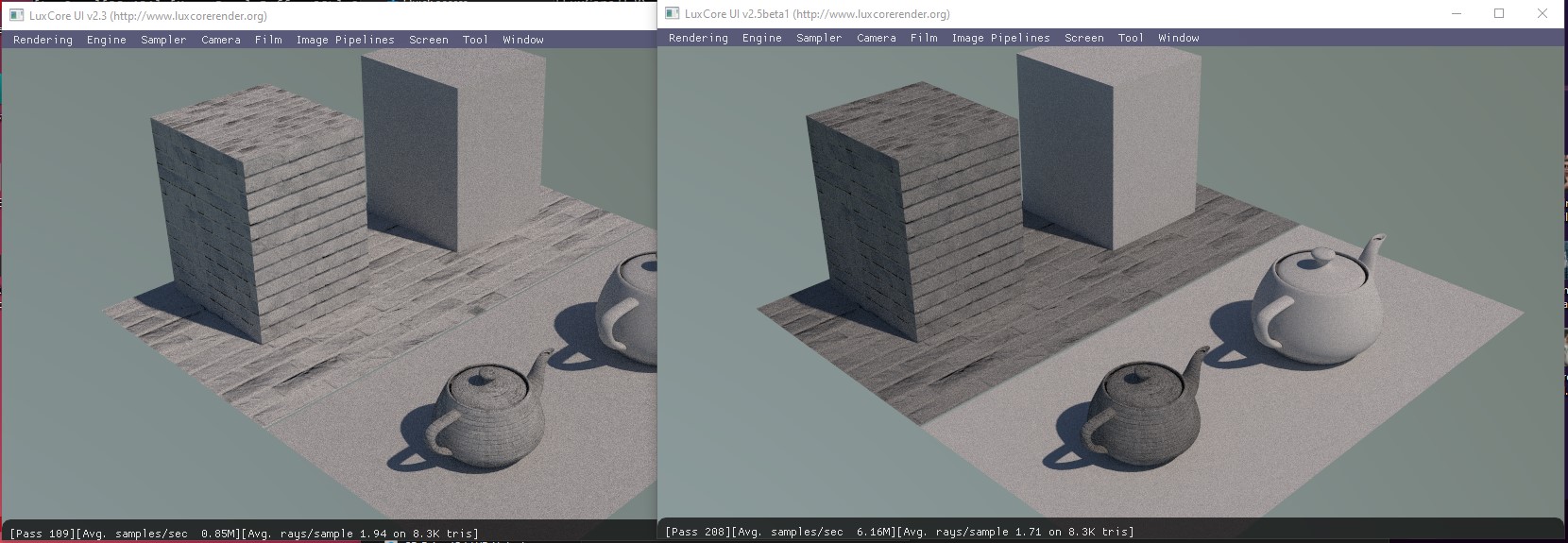

I notice if I render any type of bump with matte material sometimes the diffuse color will turn darker than normal.
First I think there is something wrong with the scene but when I render the exact scene without any diffuse color or map in a different version of luxCore it became more clear.
Here is the rendered scene and screenshot of the scene that may help to investigate the problem.
it can be reproduced with any kind of bump/normal bump.

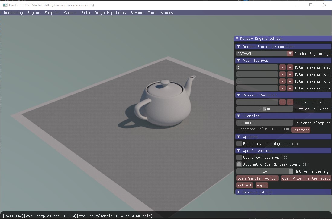

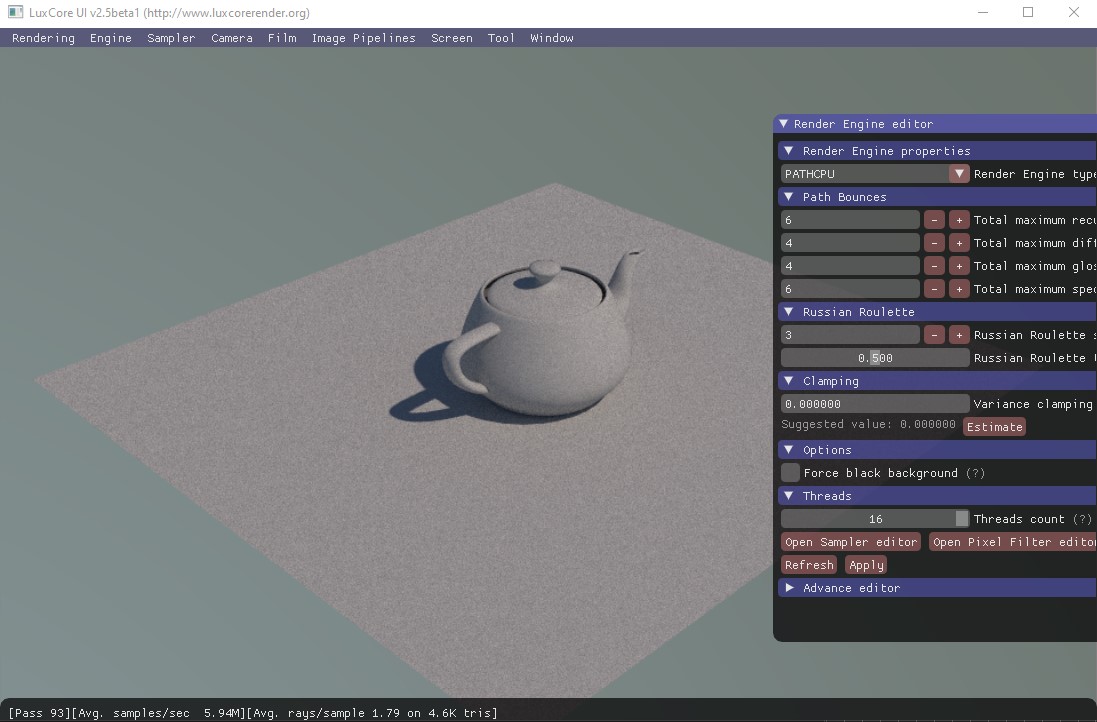

I check the other scenes too and even without textures that can happen too.
I posted the scene in a different thread but I will add it here too.
There are somethings not quite right with GPU render and it happens after v2.3. If I render the scene in luxCore 2.3 with the exact same node render will be perfect.
CPU vs GPU
The issues thread viewtopic.php?f=4&t=3011

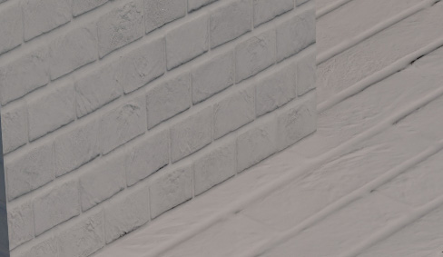

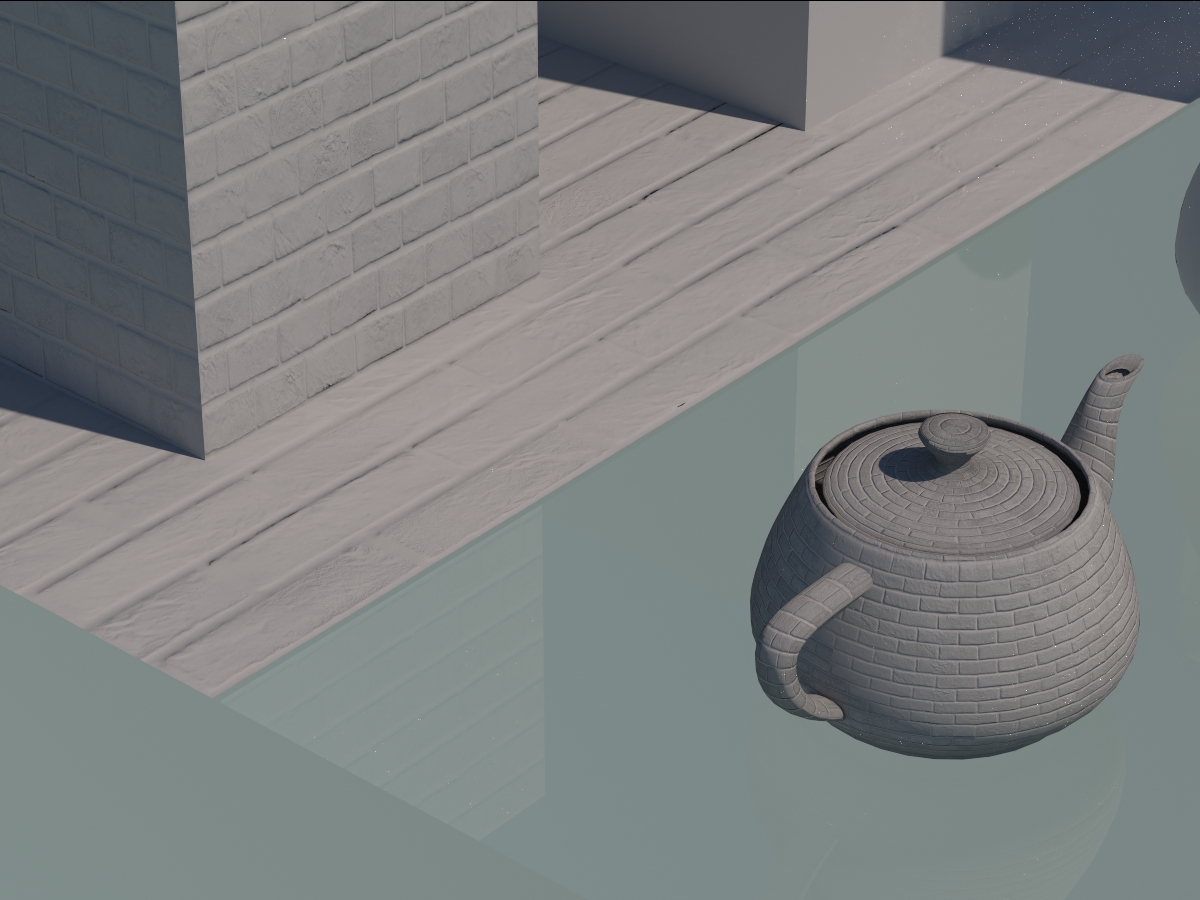

I think I found the source of the issue finally, I noticed if I use any map on bump texture the color will affect diffuse color, this happening even with black and white images and just on GPU. The strange part is with any different GPU the result will be different!!!.
Finally, If I use a non-color data image everything will work perfectly.
The images below are the result of the exact same image and exact same nodes just when I used a non-color image and both render on GPU OpenCL.
I still can see that the round objects are a little bit darker but the bump result is perfect.
the question is why is that happen only on GPU and jot CPU?
Also, as many users use standard black and white jpg images for bump texture is there any good solution to avoid this behavior?

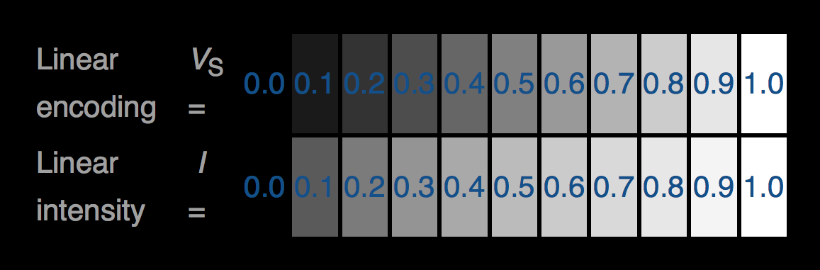

Gamma Correction is a way of compressing color data and is commonly used in many image formats, such as PNG and JPEG. Without getting into the mathematical nitty-gritty, Gamma Correction raises the intensity of a pixel to a certain power (or gamma value) to encode it, then raises it to the reciprocal power to decode it. Why would we want to do this? Here's a helpful table from Wikipedia:
Source : https://en.wikipedia.org/wiki/Gamma_cor ... eo_display
The bottom row, Linear intensity represents the non-gamma corrected values. You will observe that there is a large jump in intensity between 0.0 and 0.1 stops. In the top row, Linear encoding (meaning it is gamma-corrected), you will see that the difference in intensity between the stops is much more even.
What this means is that a basic linear scale does not equally distribute intensity as our eyes see it across the range [0, 1]. Referencing back to our image, between stops 0.0 and 0.1 on the bottom row, that whole range of color has to be squeezed into one tenth of the available range. On the other end of the spectrum, the range between 0.8 and 1.0 on the bottom only needs 0.9 to 1.0 on the top. This way, the colors that we can see are given more "space", and the colors we can't really distinguish from one another receive less.

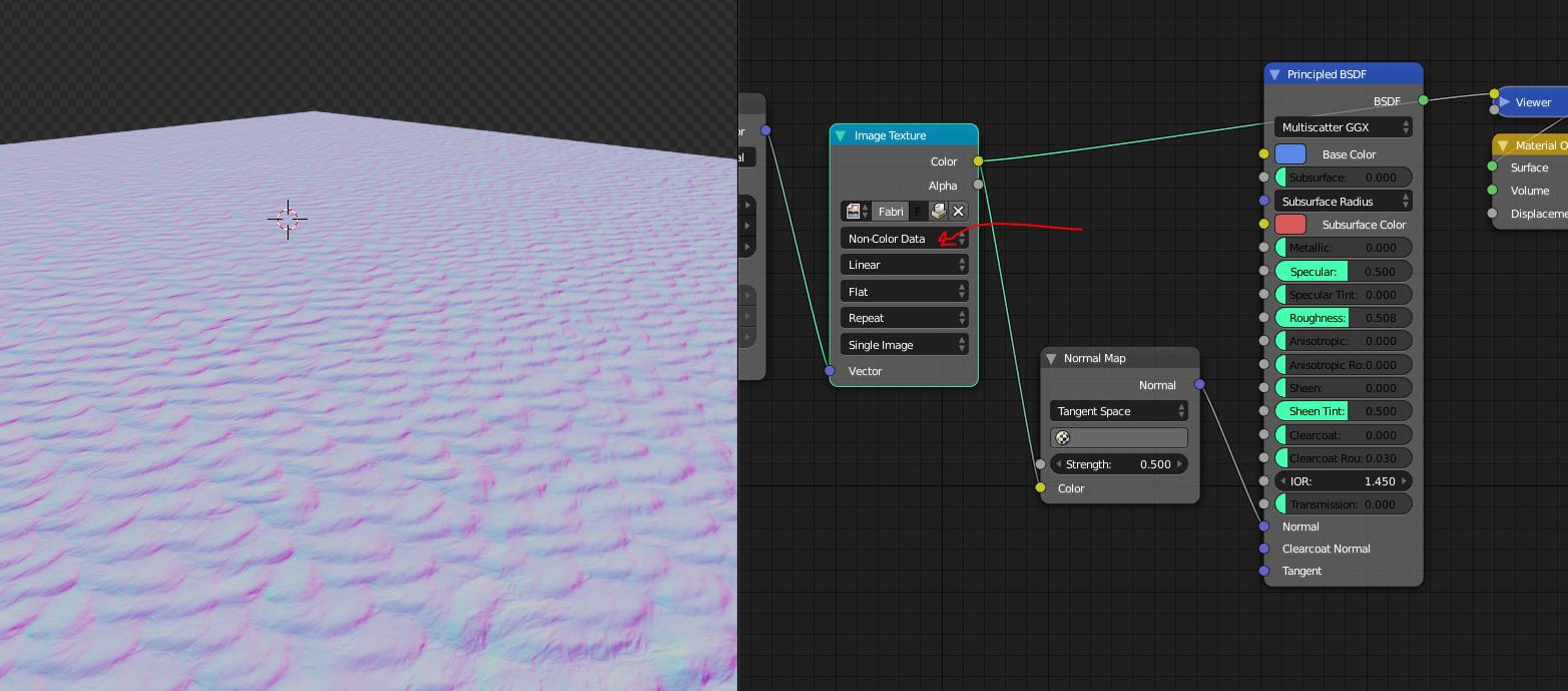

Color Data should be used for image textures being used to color a model, like Diffuse and Albedo textures. This way, they will be color managed to display their intended color values.
Non-Color Data should be used for image textures being used to store other data. For example, Normal Maps store the normal vector data of a given point on a mesh. Vectors (in this case) are linear and have no need to be gamma corrected. The same goes for other maps like Bump maps or Specular maps. These images had values stored to them on a linear scale, so they should be read on a linear scale.
Hope that all made sense. I'm happy to clarify anything.
