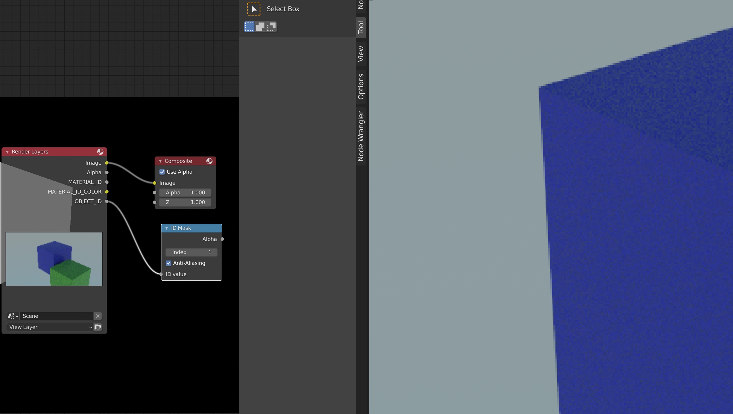

If OBJECT_ID_MASK AOV is this node then I don't know how to use it.
![Image](https://i.imgur.com/IsEGPS5.png)

by B.Y.O.B.
The OBJECT_ID_MASK and MATERIAL_ID_MASK AOVs are not yet supported by the Blender addon.
