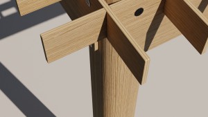

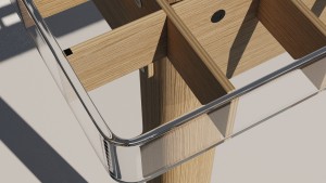

Hi. I am dealing with a new scene and I am getting some strange artifacts on some of my meshes.
I believe it has to do with the intersection between the acrylic glass and the wood. I am not sure if this should be the expected result when this happens.
Unfortunately the render looks better when the meshes intersect, I would like to keep it like that.
I am using lux 2.5
- with the glass
- without the glass

It may be not the same problem, Zooropa, just try to rise a little the glass top: if the surface of the glass and wood one are too near, due to limited floating point 32bit precision, LuxCore may detect the intersection with the glass plane and not with the wood surface (so seeing inside the closed wood box: just all black).

I would say the same as Dade. Objects with transparent materials, can´t touch other surface, because renderer don´t know what face it should renders.

Thank you. I was doing like in cycles, where they worked. Now I know, after moving a bit the acrylic glass I stop having those black artifacts.
