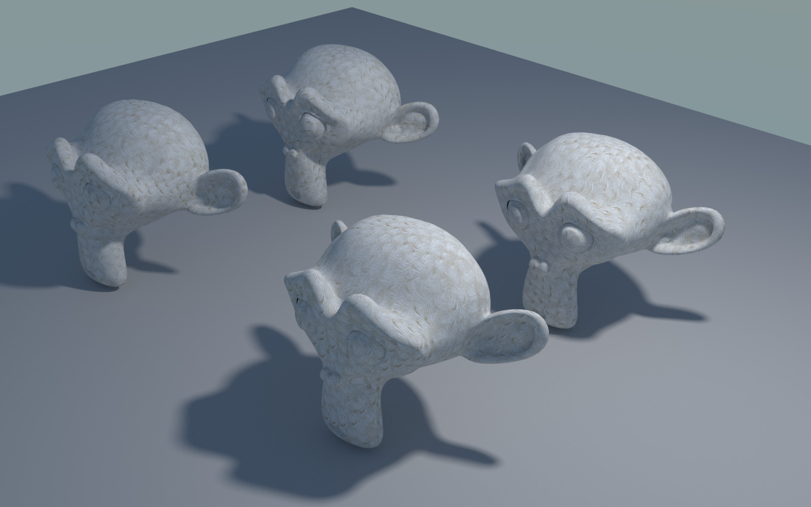

LocalRandomMapping3D
LocalRandomMapping3D can be used to achieve the same result with procedural textures:
This is a normal rendering (i.e. the procedural texture look the same on all 4 objects):
and this using localrandommapping3d:
