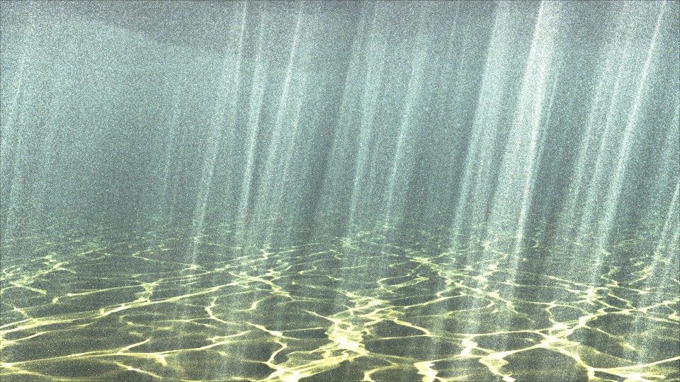

You simply have so many intermingled volumetric caustics in front of each other that they mix together into a uniform mess.
Here is a rendering of your scene with a cover over the water, blocking all the sunlight save from a quadratic spot.
As you can see, you need to take away some caustics in front and behind the ones you want to show in order not to drown them out.
Or modify the water surface so they are focused stronger.
